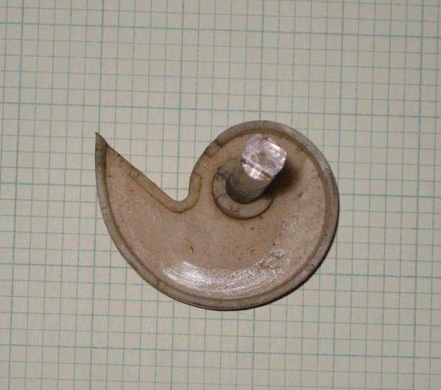

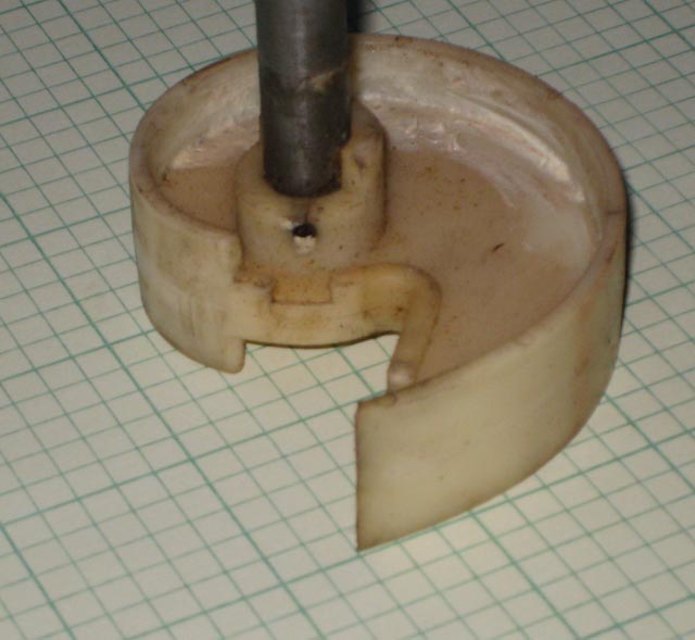

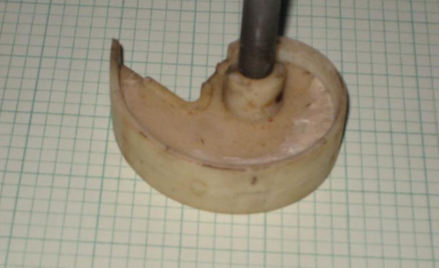

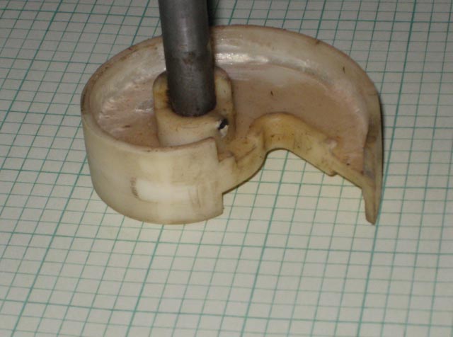

A paper trace of the profile on graph paper would be a nice thing to postdamagi wrote:I managed to get an intact control cam. I will take measurements
Mark VII Control Cam
- robinson46176
- Posts: 4182
mickyd wrote:A paper trace of the profile on graph paper would be a nice thing to post
Now you are talking... Never measure when you can superimpose / trace...
Trace sounds like a good idea...I will post whatever I come up with.robinson46176 wrote:Now you are talking... Never measure when you can superimpose / trace...
Of course, the cam came with a nearly-free mostly-complete MKVII =) The guy I got it from actually had two
damagi AT gmail DOT com
Used standard engineering graph paper:
[ATTACH]10970[/ATTACH]
[ATTACH]10971[/ATTACH]
[ATTACH]10972[/ATTACH]
[ATTACH]10973[/ATTACH]

damagi - Can you also trace the outline of the cam profile and inside diameter with a sharp pencil and take a photo of just the tracing without the cam on the graph paper. A straight on view of the graph paper similar to your second shot would be great. That way, someone could transfer the shape based on the grid.

Ya shoulda said PENCIL trace on graph paper!!!!:rolleyes: Dimensions of the cam surface thickness and the web thickness would be helpful as well as the hole location. Somethings are not 'imposable'.
FWIW, the profile should match the motion of the control sheave button when moved by the quadrant gear by a Mark 5/V.
