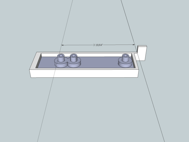

I think you just might be absolutely correct, Ron. I looked at this with blind eyes. I knew what I thought needed to be done but I overlooked a critical issue.
The two roll pins are embedded a full 3/8" into the casting. The casting that we are talking about modifying is not that thick. But, two appropriately sized collars could be JBWelded to the outside of that angle piece to deepen the holes.
[ATTACH]8561[/ATTACH]
- Riving Knife Mount (small).png (31.26 KiB) Viewed 6768 times

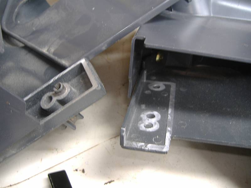

Hi,
Some where in the past we had a discussion on this and I missed the fact that the 500 dust collector had parts removed or if you rather "milled off".
In this image you see the 5++ blade guard/dust collector on the left and the 500 dust collector on the right. I guess this make since when thinking about the shorter arbors on the disk sanders....
[ATTACH]8568[/ATTACH]

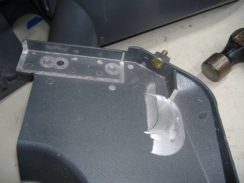

When you look inside the 500 dust collector you can see what else had to be removed. It is very clear as this operation happens after the paint has been applied.
[ATTACH]8569[/ATTACH]
If one were wanting to use the dust collect you would need to construct a block to replace the milled off one, the height of which would be established with the outside rim that is still intact. I would think a piece of rock hard maple would work. An aluminum piece would be even better. Once it is sized and tested it could be epoxied in place. It doesn't look to be that bad a job making such a piece, just make sure the holes are located in the correct position and the thickness matches.
Any one locate that old post? It would be nice to reference the two together.

Thanks again Ed! You have cleared it up!
Although the dust chute is a subset of the 5x0 lower guard, it is a modified part!
