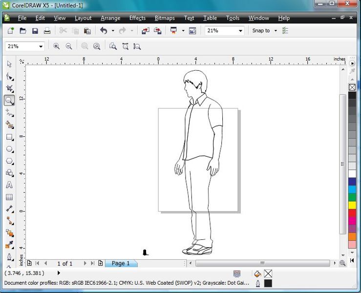

I just installed and tested it, and it does seem to work.
- tom_k/mo
- Posts: 856
- Location: St. Louis, MO

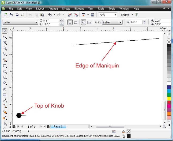

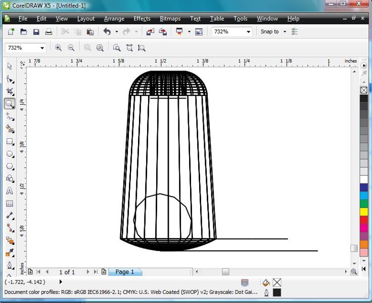

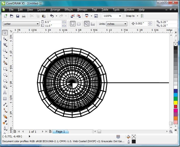

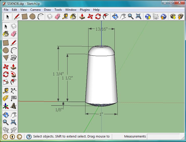

I tested a file that JPG sent me and here's the results. Let me caveat the results with the following...
- Imported the DXF file into CorelDRAW X5, just released about 6 weeks ago, with their latest import/export filters.
- CorelDRAW is a 2D graphics application, SketchUp is 3D. Importing 3D data into a 2D application is going to flatten the geometry. When importing, Corel prompts the user which plane (Top, Front, Left/Right Side, etc...) to import into.
- When exporting the file from SketchUp, it gives you the option of how to handle the 3D faces, I chose Polyface Mesh for this example.
- SketchUp-Original.jpg (66.99 KiB) Viewed 1569 times
- Top-Overall.jpg (63.07 KiB) Viewed 1564 times
- Top-Detail.jpg (92.13 KiB) Viewed 1554 times
- Front-Overall.jpg (61.77 KiB) Viewed 1551 times
- Front-Detail.jpg (69.09 KiB) Viewed 1554 times

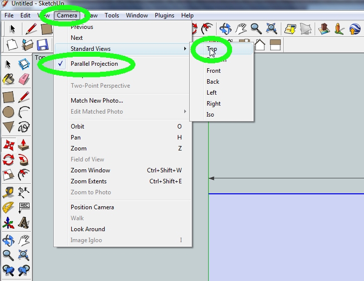

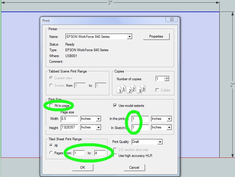

I have been messing with Sketchup again and wanted to do some printing to scale. I have version 8.0.something.
I have had some success I get it to scale but centered on four pages is there some way to select the print area?
I don't want to tape pages together for small things. Below is some pix to tell the story of what I'm doing so far.
at least I'm getting accurate to scale output. Maybe if I got a printer that printed tabloid size it would fit on one page.
This video by Matthias Wandel makes it look so easy. (at about the 30 sec. mark)
Edit... I just found this video too
[ATTACH]25037[/ATTACH]
[ATTACH]25038[/ATTACH]

I downloaded the evaluation copy of Matthias Wandel's Big print I was quit pleased with it.
If I don't run across anything that I like more I'll probably end up getting it. I would rather
have him get my 22 bucks because I have enjoyed his videos so often.
