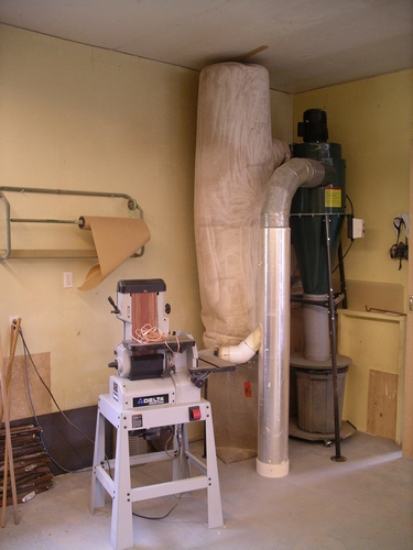

I have a 5 Hp cyclone dust collector in my 30 x40 shop here (I'm back in Canada) and I love it. The only reason however to have one is that you need to service several outlets (inlets?). When I built this shop I poured a foundation and crawl space because I'd spent too many years on concrete floors and wanted something with more forgivness for my feet, but also so that I could install dust collection under the floor. I have a 10" pvc main down the center of the shop with eight different inlets at the ends of various lengths of 6" and 4" branches. Most appear as flush holes in the floor and some can be used as receptacles for floor sweeping . It works great but again if you are using a universal one stop tool like SS, you don't need to suck air at such great volume over such a distance from so many outlets and a much smaller DC works fine. It really depends on the shop layout, size and the tools.

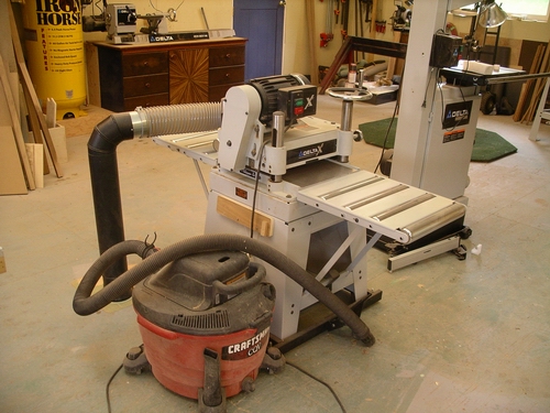

At the collector end of my main it turns 90 deg. to straight up. The 90 is a metal elbow that connects the two pvc pipes. Every year or so I remove the elbow and clean out all the heavy bits that didn't want to go straight up about eight feet. Usually its only a few nails or whatever that got swept into one of the holes. My point I guess is that unless you are using the system as a cleanup dump you don't likely need an actual sump or trap to collect them.
[ATTACH]8857[/ATTACH]
[ATTACH]8858[/ATTACH]
The shop vac is just in the way in the photo, not part of the system.
Paul M
