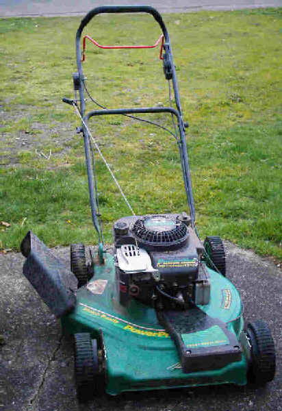

[ATTACH]8883[/ATTACH]

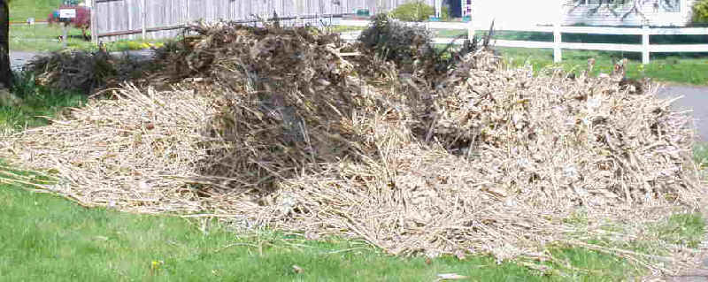

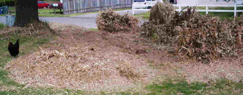

New in 1997, Just used to reduce a 6' x 5' x 15' row of Pampas grass leaves to small chips, with great exerction and very little common sense.
[ATTACH]8885[/ATTACH]

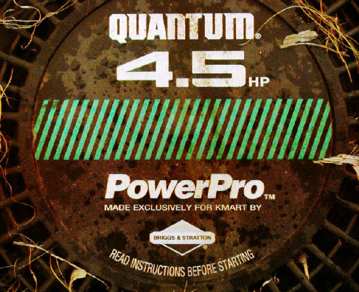

[ATTACH]8886[/ATTACH]
It would be free, but I just found the parts list to fix the SP drive, currently down to one wheel drive with a slipping belt, and 13 years cutting ~12,000 square feet. No mulch plug (fell out and got chopped up) no bag (not engineered for bag), blade adapter needs replacement, 5th sharpening of this blade, two more blades (NIB) and only uses 1/2 tank per cutting.
THis is not a sale or a thread hijacking. IT is a PowerPro.
[ATTACH]8884[/ATTACH]
Yes, Beavis told me this was a good idea. Sorry. Now what if the PowerPro name is taken,,, More delays to rename IT.
Free to anyone w/SS, if available parts would cost more than original purchase price, BUT YOU MAY GET A WEEKEND OF WRENCHING TO REPLACE PARTS, OR BETTER YET MAYBE TWO WEEKENDS!!!!!!
