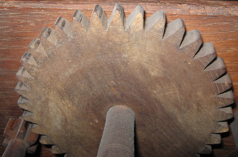

Or quite crude.
[ATTACH]8995[/ATTACH]
Typically these are found on earlier clocks but do appear on later examples. There were quite a few makers who only made a handful of clocks, farmers and others trying to make a living during the winter months.

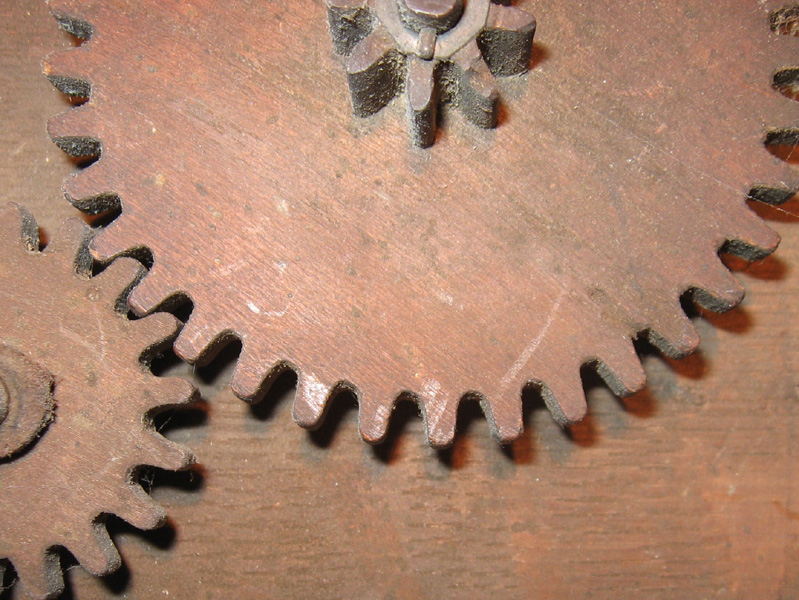

In mass produced clocks, a few used teeth milled with a single cutter, these have a rounded space between the teeth.
[ATTACH]8996[/ATTACH]

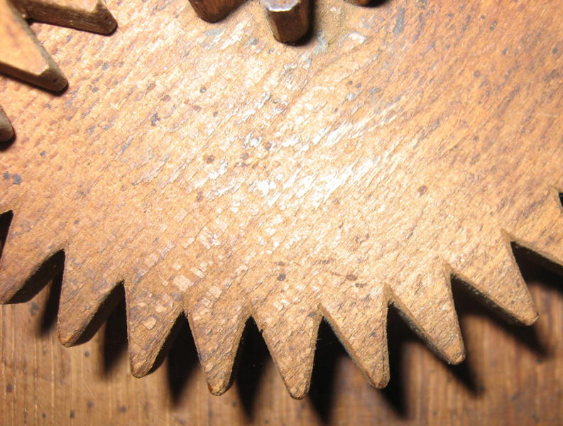

Most were made with circular saw blades and a cutter to round the tip of the tooth, the two blades and rounding cutter were run through a stack of wheel blanks, cutting one complete tooth on each pass. Thousands of clocks with these movements were made.
Note the peak left by the two circular saws between the teeth.
[ATTACH]8997[/ATTACH]
The point is (yes there is one) that conventional gearing and extreme precision can be detrimental in a wood works clock. This simple tooth profile gives maximum strength at the root where it is needed and has withstood the test of time. Even with quartersawn lumber the dimensional variations mean that designing to extreme tolerances will produce nothing but headaches. In the wood works community there is a saying, if it will rattle it will roll.
