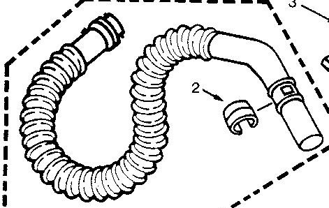

The best way to control suction on a vac is the simple bleeder as used on household vacs for many decades. It is just a hole, usually about 1/2" or so with an equally simple way to control the size of the hole. Most household vacs have long used either a tiny slide door or a ring that you rotate to cover part or all of the hole. It works exceptionally well and you don't risk overheating of the motor due to the cooling fan being ran too slow.
The twist ring (marked #2) in this pic is the most common.
[ATTACH]15537[/ATTACH]
If you want to get a little more fancy consider a cheap ball valve.
[ATTACH]15538[/ATTACH]

robinson46176 wrote:The best way to control suction on a vac is the simple bleeder as used on household vacs for many decades.
Thanks Francis, a brilliant simple idea. I'm putting the Festool back in the running now that I know I can use my existing DC with a bleeder if needed to control the suction. I really want to be able to sand without breathing all that dust and making a mess of the shop.
