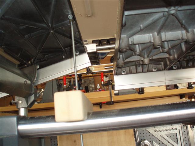

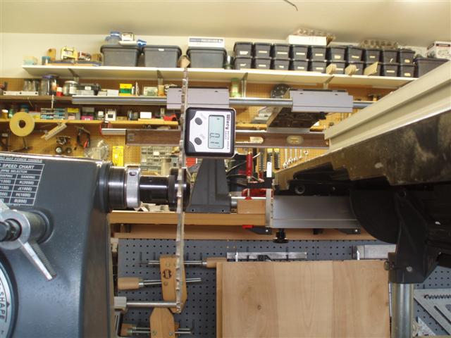

I have had the need to tweak table tilt angles and I found it very frustrating to get it right. The problem (for me) was significant but the solution was obvious and simple.
Now most times and for most people this is over kill but occasionally it is needed. I use it seldom but when I need it, it is there.
[ATTACH]9644[/ATTACH]
A reference point, the plane of the blade.

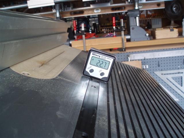

[ATTACH]9645[/ATTACH]
The final objective, not a hard stop.

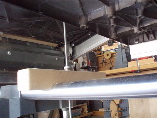

[ATTACH]9646[/ATTACH]
A threaded rod to lift the table.
[ATTACH]9647[/ATTACH]
A block of wood, a knurled nut, a washer, and a threaded rod.
