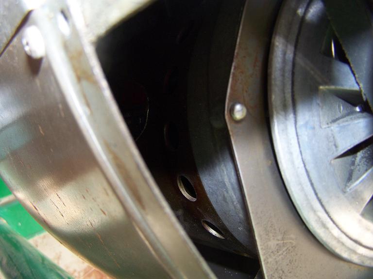

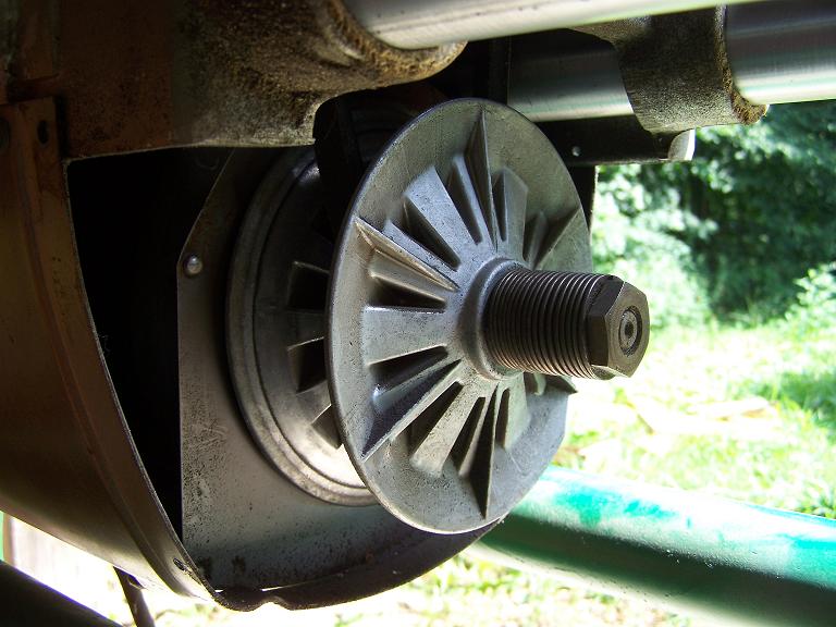

My other greenie (SN: 291340) has the threaded motor shaft (see attached). There is no washer between the spring and nut. How in the world would you compress the spring to get the nut on?judaspre1982 wrote:Hi Ron
According to the paperwork I have there were a couple changes made to the way the spring was secured. The first models had a threaded motor shaft with a threaded nut to hold the spring in place.
Also the mot0r appears to have holes in the casing all around it. I assume for cooling (see second attached).
Sincerely,
Ron309753

Ron309753 wrote:My other greenie (SN: 291340) has the threaded motor shaft (see attached). There is no washer between the spring and nut. How in the world would you compress the spring to get the nut on?
Sincerely,
Ron309753

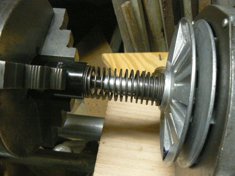

Here's one way!
[ATTACH]9748[/ATTACH]
Socket mounted in chuck mounted on ss output shaft, use quill to position socket/nut, depressing spring, manually rotate motor pulley to advance nut. Motor sitting on board sitting on way tubes. Nut spaced inside socket so as to be at open end of socket.
Precise alignment important!;)

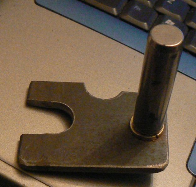

I use the following to depress the newer type(clip).
- motor spring depressor.jpg (77.48 KiB) Viewed 4788 times
- motor spring nut insallation.jpg (96.29 KiB) Viewed 4841 times
