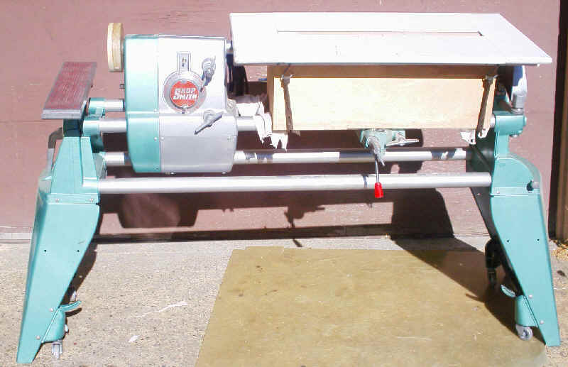

I AGREE w/Gene. Built a Hook and Loop (V Drum) sander for Mark V.
The Hook and Loop sander collects 90% of the dust in the case that supports the table. DC is an option and the drawdown should capture 9% more. Remember sanding creates a lot of dust and even 1% floating around is a lot. One of several advantages of Hook and Loop Sander is that it will remove paint without clogging the sandpaper for the same reason that it is unlikely to burn the wood!
[ATTACH]14441[/ATTACH]
I have free plan for Sander Case and building a hook and loop drum for the first Forum member that will commit to building a case and drum for himself and informing Forum members.

If you have plans for that I'd love to have them. My dad's next door neighbor made the Shop Notes one and has it attach to his PowerMatic Table Saw pulley. I could see the use of your design for my '55 SS MkV. Thanks ahead of time. It would be great addition to tools for making my electric guitars.
dwevans wrote:I made one which works fairly well for thicknessing acoustic guitar sides. I borrowed ideas from ShopNotes (tm) and Nick Englers sanding book. Here is what it looks like:
Just have to watch the exit as it does tend to want to through the piece. I limited that by adding a top roller on the outfeed to maintain downward pressure on the feed belt. That resolved 95% of that issue.
Almost forgot to mention, it's a full 18" wide. and just barely fits on the Shopsmith, but it will sand acoustic tops and backs that are already glued to size.
