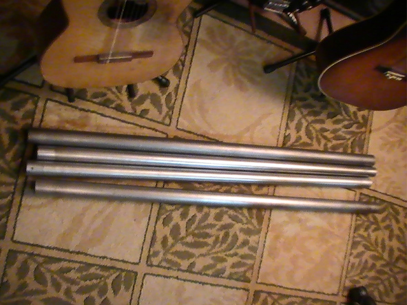

russsaw
Posts: 46
Joined: Mon Nov 08, 2010 8:35 pm
Post by russsaw »
Here's a few pictures of my electrolysis setup. The way tubes are now looking way better but they still don't shine like I would like them too despite my scotch pad and wet/dry sand paper. Any suggestions?
