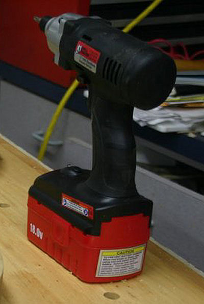

Author found thread extremely helpful in making the determination. Went with an 18V impact driver........HF.......$20 for driver + $10 for battery + $5 charger. My needs were more toward driving lags, long screws, loosening frozen fasteners so that made the most sense. I rarely drill into aggregate / stone so impact wrench made sense.
[ATTACH]11104[/ATTACH]
impact wrench.jpg (43.18 KiB) Viewed 6753 times
Sunny San Diego
