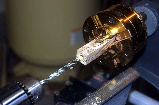

Bob, here's how I drill my pen blanks. Using this method there is no problem at all with centering the blank and ensuring the blank is parallel with the drill bit. I've been very pleased using this method.
[ATTACH]11219[/ATTACH]

tom_k/mo wrote:Bob, here's how I drill my pen blanks. Using this method there is no problem at all with centering the blank and ensuring the blank is parallel with the drill bit. I've been very pleased using this method.
Since there has been some dissatisfaction with the 'stability of the SS tailstock expressed in some earlier threads, I have to inquire why the reverse arrangement of the chucked workpiece and the 'quilled' bit.
This arrangement makes more sense to me since the quill is what feeds the rotating drill as opposed to a tailstock fed stationary bit.
Just wondering why you choose to do it this way.

I've done it with the chuck on the quill end and the chuck on the tail-stock end. I have better results with the chuck on the tail-stock end. There IS a small chance that the blank can be clamped in the chuck not perfectly centered. If the chuck is on the quill end and the drill bit is in the tail-stock, the end of the blank furthest from being centered would be the exposed end where the drill bit would contact first. With the drill bit being stationary and the blank rotating slightly out of center, it can create an over-sized hole in that end. With the setup as shown, the blank is stationary,and we KNOW the drill bit is rotating on center of the quill. If the blank end is slightly off-center, it will still drill the correct sized hole, just not perfectly in the center of the blank.
Makes a lot of sense!!!! Straight correct size hole (albiet may be slightly off center of the surfaces to be removed!).tom_k/mo wrote:I've done it with the chuck on the quill end and the chuck on the tail-stock end. I have better results with the chuck on the tail-stock end. There IS a small chance that the blank can be clamped in the chuck not perfectly centered. If the chuck is on the quill end and the drill bit is in the tail-stock, the end of the blank furthest from being centered would be the exposed end where the drill bit would contact first. With the drill bit being stationary and the blank rotating slightly out of center, it can create an over-sized hole in that end. With the setup as shown, the blank is stationary,and we KNOW the drill bit is rotating on center of the quill. If the blank end is slightly off-center, it will still drill the correct sized hole, just not perfectly in the center of the blank.
