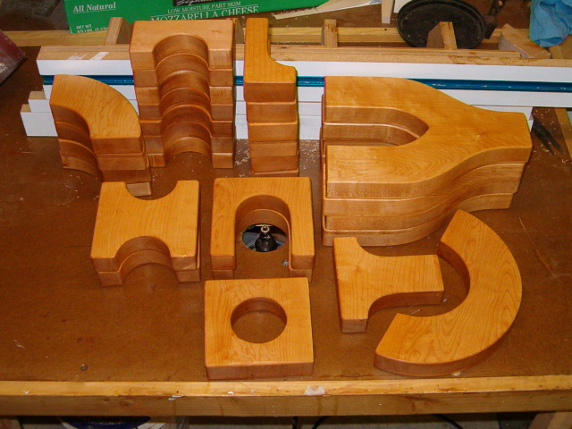

I've made some blocks, ordered by my school teacher Daughter-in-law. Maybe these are the kind you are looking for. These are made from maple. Finished size is 1 1/4" thick. The "Ys" are about 10" tall. Once a pattern was made from hardboard, tracing and copying is easy. - Used a bandsaw and sander. Then used a 1/8" roundover bit to soften all edges.
Two "Ls" back to back make a "T". Two small arches can be drawn back to back or together to mak a hole in the center, etc.
[ATTACH]11290[/ATTACH]
[ATTACH]11291[/ATTACH]
[ATTACH]11292[/ATTACH]
[ATTACH]11293[/ATTACH]
