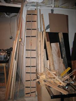

Fine Woodworking had a really cool (video) "A Planer Sled for Milling Lumber".
http://www.finewoodworking.com/SkillsAn ... px?id=5245
Also a pdf article "Flatten Boards without a Jointer"
http://www.finewoodworking.com/SkillsAn ... x?id=24118
If you do have (or get) a planer][INDENT]
8iowa wrote:Take a long straightedge and draw a line down the board close to the edge. Then put a 5/8" wide blade in the bandsaw and saw down the edge. You will be amazed at how straight an edge you can cut, so straight in fact that you can usually go right to the jointer, skipping the saw.
I've done boards as long as 104" this way. For long boards it helps to have roller stands on both infeed and outfeed sides of the bandsaw table.
[/INDENT][/INDENT]

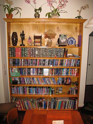

Finally, to get out all the twists and bowing the Planer Sled does a great job.
The last project required long boards for a 8' x 6' bookshelf.
My bride keeps asking what all that wood is for... sheesh! :rolleyes:

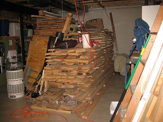

Bookshelf [ATTACH]11432[/ATTACH] Planer Sled[ATTACH]11433[/ATTACH] Sticked Rough Sawn Stock[ATTACH]11434[/ATTACH]

Back when I still had the big bandsaw mill and was doing some custom millwork I found that I could do a lot to prevent twist in a small stickered pile of lumber by restacking it and putting anything trying to twist on the bottom. I have also put some short scraps of lumber crosswise above a row of stickers and stacked weights (usually concrete blocks) on those boards to hold everything flat including the boards on or near the top.
