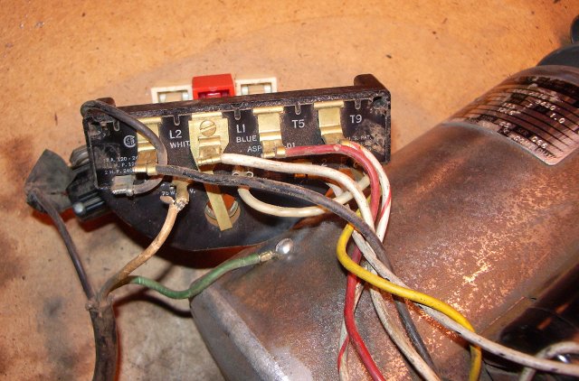

[ATTACH]11347[/ATTACH]
If the continous coil voltage is 300VAC and the nominal pick-up is 266VAC, then maybe the MARS 551 is a better choice.
What do think; am I all wet? :(
~Ryan

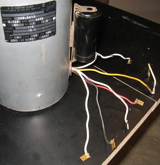

I have a second motor from another Mark VII. It's just had a bath and fitted with new bearings. It has a start capacitor and wires - no "black box".
Just to bench test this motor; what wires can I connect to check it for forward operation?
Yes, the power cord has black, white, and green (gnd). What on the motor needs to be connected?
[ATTACH]11357[/ATTACH]
Thanks again for the help and patients with a newbe
~Ryan
This help?
[ATTACH]11365[/ATTACH]
And this
[ATTACH]11366[/ATTACH]
See next post for 'bench test' wiring. SECURE before powering up!!!!! It will jump off the bench if not!
wh to power neutral
blk to power hot
red to yellow
redwhite to whiteblk
reverse red/redwhite to reverse direction.

1/2 cool... :(
Forward direction works very smooth. :)
Reverse direction does not rotate, hums loud, and gives off unsavory toasty smell after only being plugged in for 1/2 second. :eek:
Just to confirm reverse direction bench test wiring: :confused:
wh to power neutral (white)
blk to power hot (black)
red/redwhite
yellow/whiteblk
~Ryan
