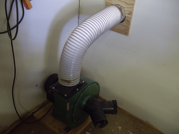

I can only speak to the HF unit.
Took off both bags and directed the outlet (did go to the bags) to a short piece of 4" stove vent pipe through the wall.
The HF unit is fairly quiet and I don't think my modification altered the sound.
Gene

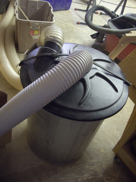

I think his concern is that the 'trash can separator' may let some fine sanding dust get through to the collector and that it would be blown back into the air rather than being captured by the filter bag. If your are not noticing any dust accumulation in the shop I wouldn't worry about it, but I would probably leave the bag on just in case.
Can you provide pictures of the separator? How is it constructed and connected?

I may get a little leakage out of the separator lid....not much, though.
When I first put the separator inline, I lined it with a large garbage bag. I stopped that after a few empties. Didn't see any differences.
The whole idea was to save the space needed for those bags. An added benefit is not having to empty and clean them.
Gene
Gene Howe
Posts: 3219
Location: Snowflake, AZ
Post by Gene Howe »
Here are pictures of my HFDC mod and the trash can separator.
Gene
