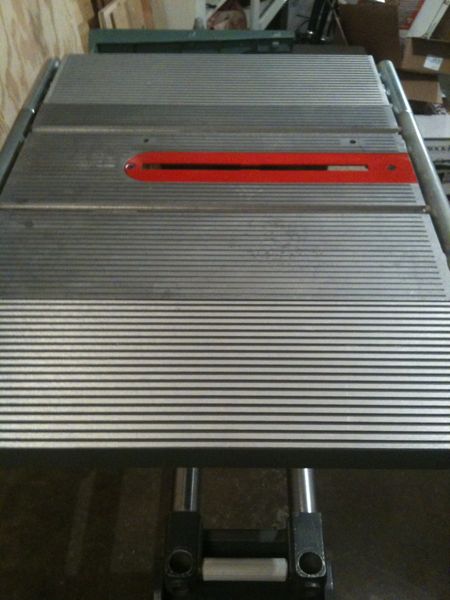

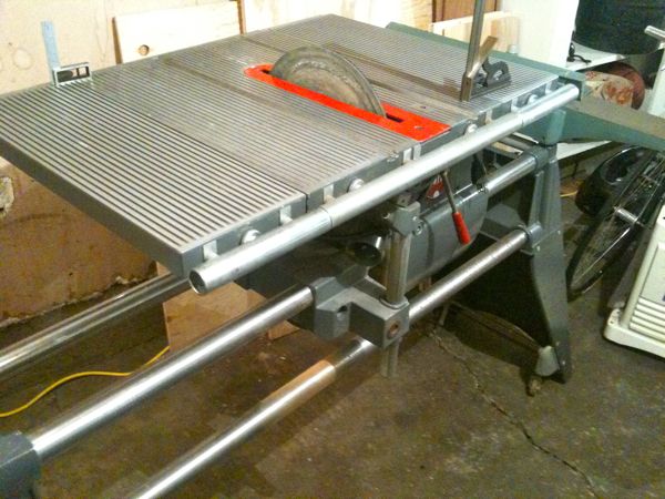

Older 510 main table not aligned to new table extensions?
I just took a look at my 510 and see that the table surfaces are not on the same plane. I didn't measure the misalignment, but I guess it was about the same 2mm seen by cobalt60. I loosened the four nuts that secure the tubes to the table to see if there was sufficient slop in the assemblies to allow a fix for the misalignment, but there isn't enough. So, I'm thinking that a simple fix would be to bore the holes in the table a bit oversize so that I could raise the table by lowering where the tubes attach to the table.

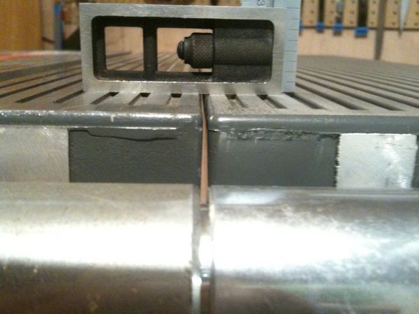

Hi dusty, I tried that exact procedure over my lunch break. Well, only on one side, since the far-side-middle bolt of the main table is like RIGHT up against the metal angle indicator thingy. huh.
Anyway, I did a half-assed version of this, and the result was the main and extension tables perfectly parallel, but both extension tables still equally lower than the main (about 2mm).
I'll try again tonight, this time with conviction (and a straightedge and clamps, etc.)

Whoops, edited in my mistake. Yes, I swapped the inside diameter measurements -- the main table has the extra room. Apologies for adding confusion here!

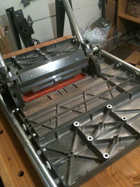

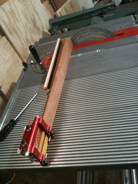

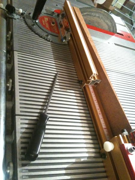

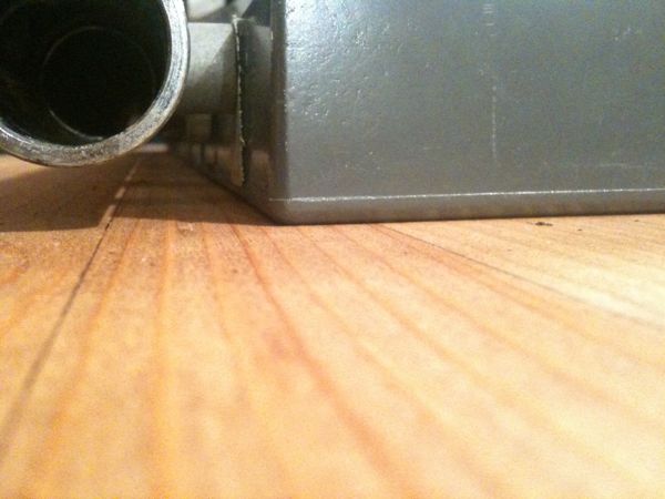

Here's the results of trying much harder to force the tables into alignment:
Laid the tables flat on my bench, loosened ALL bolts, inserted tubes and tightened everything up.
[ATTACH]11517[/ATTACH]
[ATTACH]11516[/ATTACH]
Dropped it back in and ... results?
[ATTACH]11518[/ATTACH]
[ATTACH]11519[/ATTACH]
Welp, not great.
Welp, not great.
[ATTACH]11520[/ATTACH]
It's closer than before, maybe 1/64" instead of 2/64". But it's NOT OVER YET. (I'm just out of photos for this post)

OK, I'm not giving up. I'm sure now that the amount of vertical play is equal or greater than the offset. So I just need to try harder, right?
Here's me holding the table in place by hand, thumbscrews totally loose:
[ATTACH]11521[/ATTACH]
And here's a pretty-good job of hand-alignment with everything tight:
[ATTACH]11522[/ATTACH]
OK but honestly that seems VERY fiddly, to the point where it just doesn't seem "right." I wonder how it holds up to some basic work.
[ATTACH]11524[/ATTACH]
[ATTACH]11523[/ATTACH]
It seems to stay put after some basic pushing around and jostling. I guess I can deal with fiddly setup if necessary, but it's not ideal.
Honestly, I can't help wonder if things would just work better if I had matching tube diameters. Let me know if this sounds silly: I think I'll call SS Customer Service and see if I can buy two replacement main table tubes -- with the express intent to return them if they don't improve the situation.

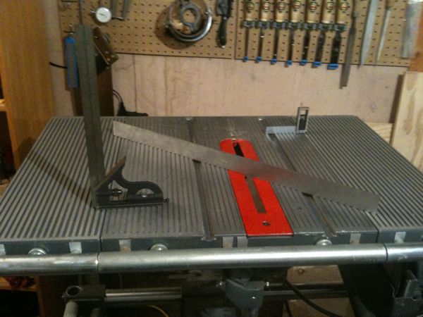

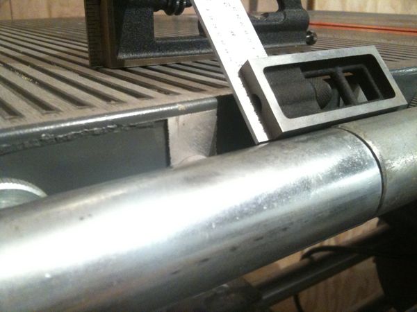

In looking at the misalignment of the tables on my 510, I tried to adjust the studs and nuts that hold the tubes to the floating table, but found virtually no room for adjusting the table height because the diameter of the holes in the table are a pretty good match for the diameter of the studs. As I recall they are about 1/4" diameter.
I'll take another look tomorrow and try Dusty's method of alignment. If that doesn't work, I'll just drill out the holes 1/64" larger at a time until I can get the tables on the same plane. If I screw one up, there's always JBWeld.
