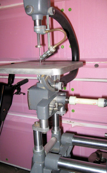

I just bought what looks like a never been used Magna Jig Saw but it has a 1/2" shaft and obviously I have a problem if I want to mount it on my 510. I don't have a manual so I really hate too tear it apart any ideas on how to make the transition, Again cheers for a job well done.
You need a 5 spline drive hub with a 1/2" hole in it to mate up with the normal plastic connector. I believe the jointer uses the same 1/2" hub, available from Shopsmith.
[ATTACH]11886[/ATTACH]

All the SPTs use a 1/2" shaft, whereas the quill is a 5/8" shaft. You can either snag a hub from another SPT or buy one off of shopsmith/ebaymel wrote:Oh Man you did a beeeeeeeautiful job! I have a 56 that i have been toying with refurbishing but I would be so much further ahead to just buy yours but---not the same thing is it. I was going to make a Mini out of mine.

Actually, the SPT's have either a 1/2" or 5/8" shaft, not just 1/2". The coupling kit that Shopsmith sells offers hubs for the headstock and SPT hubs in 1/2" and 5/8" bore diameters.damagi wrote:All the SPTs use a 1/2" shaft, whereas the quill is a 5/8" shaft. You can either snag a hub from another SPT or buy one off of shopsmith/ebay

good to know...I stand correctedSDSSmith wrote:Actually, the SPT's have either a 1/2" or 5/8" shaft, not just 1/2". The coupling kit that Shopsmith sells offers hubs for the headstock and SPT hubs in 1/2" and 5/8" bore diameters.
