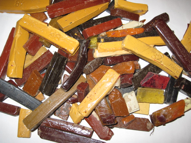

If you're not familiar with burn-in sticks or lacquer sticks or shellac sticks, here is an assortment of some of the colors that are available for repairing.
[ATTACH]11783[/ATTACH]

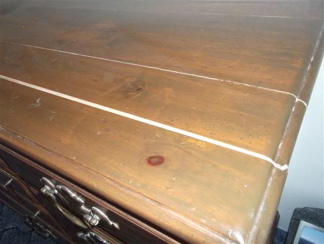

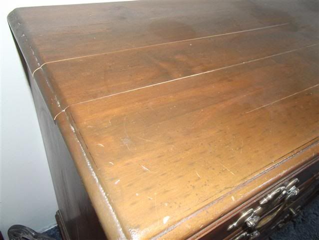

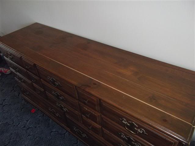

Here are some pics.
Top of the dresser:

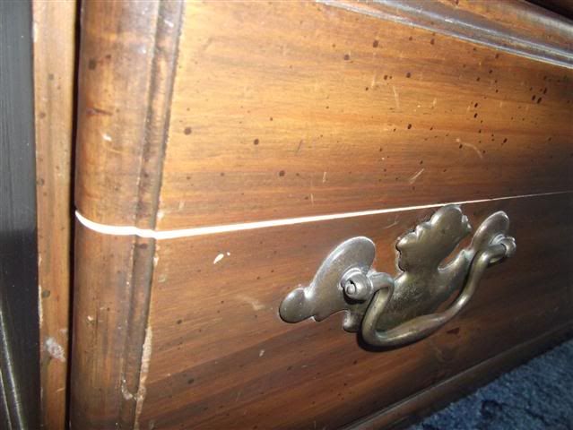

One drawer face:
Heath

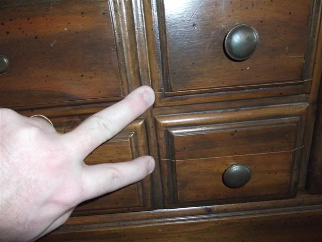

Another drawer face (two splits - each finger pointing to one):

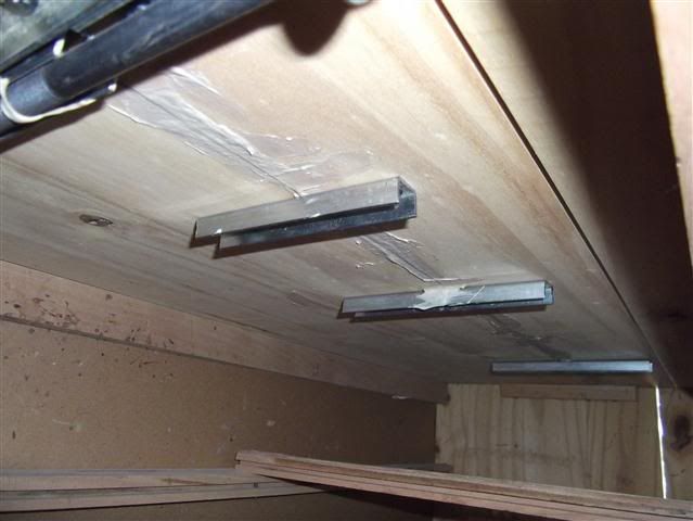

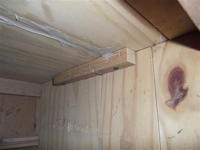

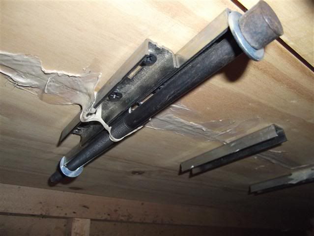

Previous repair attempts - this is the underside of the top:
Underside of right end. You can see a previous split repair, the new split in the top, and a new split in the side.

It looks to me that you've had a bunch of glue joints fail on that chest and that someone used mastic/construction adhesive to attempt that one repair shown in the photos. And it looks like you've got quite the repair job ahead of you.
If you can clean all of those joints adequately, perhaps epoxy and clamps will put it all back together. Also, someone earlier mentioned the pocket hole screws and this likely would help pull together those open joints without the need for clamps if you can figure out a way to hold the jig in place while drilling the holes on the inside surfaces of the carcase. Alternatively, if you can remove the top, you can still clean up those joints for regluing with a jointer or table saw, and then add a filler strip at the back of the top to make up for what was removed.
Good luck.

These are glue joint splits or failures. I would remove the top. Remove all the patch work from the bottom side. I would insure I had all the metal off the wood.
I would then rip the boards down the glue joint, joint the edges and reglue using a good quality wood glue.
On the drawer fronts I would first try to remove the fronts. If that can be easily done I would treat them the same as the top. If they can't be easily removed I would try my hand with burn in lacquer sticks.
If you try anything else you will have a failure. The existing joints are filled with crud that you will never get out, just rip them, joint them and reglue. If you do it careful you fix will be permanent and invisible.

I agree with Art. What I see are failures of glue joints. Have no idea of the white substance in several of those old separations. I call them separations rather than cracks, as the wood, both in the top and drawer faces look intact. You can even see length separations along the short edges of the top.
My suggestions to repair this dearly held piece of furniture would be to disassemble the broken parts - clean out the white stuff - re-joint the edges and re-glue and re-assemble. At this time I can't tell how the top was fastened to the chest, but I would bet all four sides were firmly fastened. (see P.S.) This would have not allowed for any wood movement front to back and the stress caused the joints to fail, rather than splitting the wood.
There are several methods to attach a top which will allow wood movement.
There are also several reasons why glue joints would fail, but that no longer matters. What remains is to re-join them.
I don't have a good idea why the joinery on the drawer fronts failed, but they can be repaired by the same methods used on the top. Maybe you can remove the drawer fronts.
As for color - I will be very happy do defer to jimsjinx and Ed for their expertise. It's my simple thought that the top can be re surfaced and re stained as one piece. The drawer fronts may need more exacting coloring methods.
P.S. Now I see the top was fastened by using blocks (without slots) both on the side and long edge. This is the culprit that caused the failures.

I have done work repairing stuff like that, and to be honest, it sucks. I would put a high price on that resto job, if it came into the shop. There is most definately a failure in every glue joint on that piece. Probly clamped too hard and starving the joint. (automated clamping at the factory) I'd bet every piece made on that run, fell apart! You're lookin at getting REAL intimate with that one! Just remember what material ends up as sawdust on the floor. I try to keep the shortage to the rear,so I can add a strip to the top so it is to the back edge. I'll promise you this.. it's gonna be a strong dresser when you get done. More good news is the cracks are straight down the joints, and look fairly clean. With exeption of the "counter top " hack job done in the past. What a mess! I use a die grinder to remove that liquid nails crap. I get the majority of it off, and avoid grinding the wood as much as possible, then clean up with 80 grit on an orbital sander. If you get it all apart, then it's like putting together a kit! Good luck with it, and if I was charging for a resto and refinish, you'd be looking at about $1200.00. So your wife is gonna owe you bigtime! Be cautious of the pine. If it is a veneer top, it's gonna be very thin. Not much room to sand without going through, as I noticed it is a poplar substrate. That thing would be beautiful if you stripped it and went natural pine. The wood has aged, and I'd bet it is a real mellow gold color. Just a thought. I wish I could strip it for you, I can get it spotless in about an hour! The "flow over" strip system I use is a huge timesaver! Problem is, the stripper is 70 bux for 5 gallons, and it takes 5 gallons just to charge the system! jimsjinx
