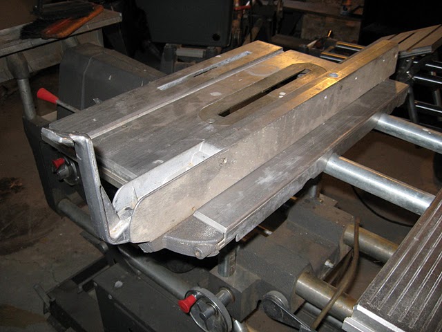

The old Mark VII goes both ways (table tilt wise I mean
) And... already has a reversible motor.
See I said that they should have started with it.
It also has a rather different table tie bar that drops down in the middle and gains clearance for it by having a dip in the carriage between the way tubes. I "think" that dip in the carriage gives it a little more swing over the carriage in lathe mode. Here is a picture of the table showing the dip in the tie bar.
[ATTACH]11935[/ATTACH]
And here is a picture of my Mark VII where I "think" that you can see the matching dip in the carriage to clear the tie bar. It dips maybe an inch and that is where I think there may be increased swing. I do not know if you can use the universal tool rest on it or not. I suspect not.
[ATTACH]11937[/ATTACH]
Notice that in this picture that the kind of unique fence lock cam is released. When locked it lays flat in the notch in the end of the fence.
Probably more than you wanted to know.

robinson46176 wrote:The old Mark VII goes both ways (table tilt wise I mean) And... already has a reversible motor.
Probably more than you wanted to know.![]()
NEVER happen!!!!!!
BTW: Yer talking a (Mark VII - Mark 5/V) to Mark 7 'conversion'!
