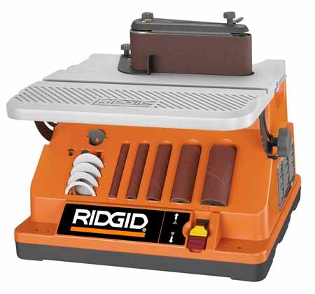

JPG40504 wrote:That ain't what he meant. He wants to be able to edge sand a flat workpiece by setting it flat on the table with the 'edges' vertical and the belt sander running l-r(or r-l) and the width of the belt vertical.
At least that is what I thought he meant!
OK, it finally soaked in to me too. :)
Pretty much the same way my Ridgid oscillating spindle/edge sander works in belt mode. Like this but with the little stop removed.
[ATTACH]11949[/ATTACH]

robinson46176
Posts: 4182
Post by robinson46176 »
judaspre1982 wrote:I never new they made such a tool--cool!
Dave
I have been quite pleased with it so far. I can't really speak to its durability yet but so far so good. Since both the spindle sander and the belt sander oscillate it does a very smooth job and does not leave any little ridges or grooves.
That front of the table lowers so you can edge sand at an angle. I don't recall its price but it was fairly inexpensive. I think I got it at Home Depot.
