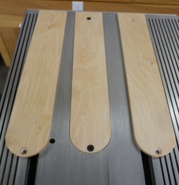

I tried the 1/4 inch Mdf core and although it is a full 1/4 inch it still sets way low. I decided that 1/2 baltic birch plywood was the way to go and with a little resawing and thickness sanding I now have 3 plates that are perfect. This is a Pet Peeve with me because I believe the most dangerous thing about the jobsight table saws are the throat plates that do not fit well. I want mine flush with the surrounding table. Setting low allows the stock to move and is very dangerous on smaller pieces. I think Shopsmith needs to address this with a redesigned plate with adjustments similar to those found on Unisaws and other stationary saws.

[ATTACH]11971[/ATTACH]
Well if they don't look just like ceiling fan blades. And I haven't thrown away the blades from the last fan I replaced, either. Flat, strong, smooth, impervious to atmosphere, hm, now if they're the right thickness...

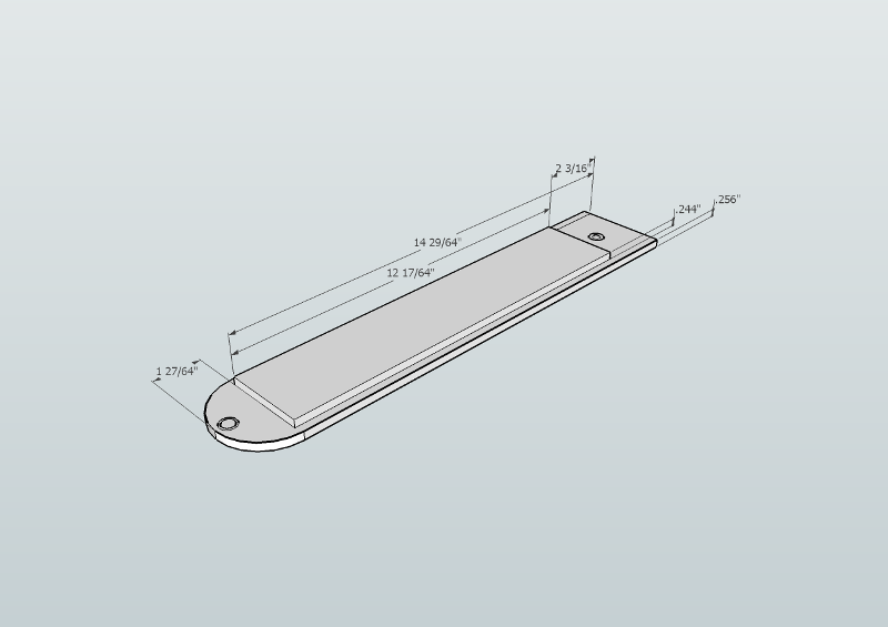

Zero Clearance Plates

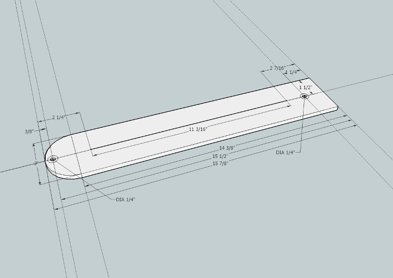

Mark, would you please check my drawings against the ZCI that you made. I am wondering if the table cutouts are universal between the various table models.
I also have a question about the cutout for the blade. Should it be left exactly as the blade cuts it when the table is lowered or should it be made a touch wider so that the blade does not rub. I have been widening it ever so little. I even have a couple that were cut with other than thin kerf blades.
[ATTACH]12074[/ATTACH]
I find that the thickness needs to be .254" to .257" thick.
dusty wrote:Mark, would you please check my drawings against the ZCI that you made. I am wondering if the table cutouts are universal between the various table models.
Dusty the inserts are pretty much universal on all of my 510's and 520's. The thickness may need to be tweaked but other than that I do no see a problem.
As to the cut out all I did was lower the blade and very slowly tighten the table lock. It moved just a bit but with the blade still running It will stretch the cut out to the correct size.
Mark
2017 Power Pro Mark 7
Thanks for the feedback, Mark. I have been deliberately widening the cut but I'll go for awhile without doing that.
