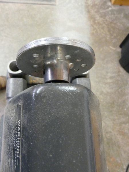

Here are a couple of tips.
[ATTACH]12174[/ATTACH]
The small face plate makes a great hand wheel when installed on the upper output shaft. This makes quick work for positioning any lathe work. Just make sure that it is nice and smooth with no nicks sharp edges etc.
[ATTACH]12175[/ATTACH]

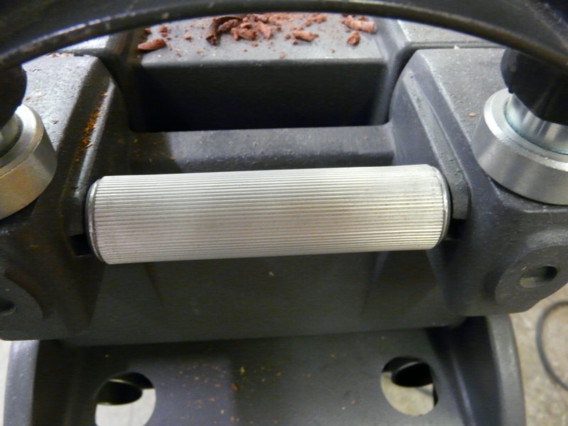

Install you SPT locking handles so that when you grab them you spin them up to loosen and down to tighten. Then all you have to remember is up for up (as to remove) and down for down (as to install) your SPT or tailstock.
That's backwards to me! Tis easier for me to apply more torque to the handle to tighten by rotating outside up. It also allows it to be used as a secure handle when moving the ss if a tube is inserted in the spt mount.
To each their own.

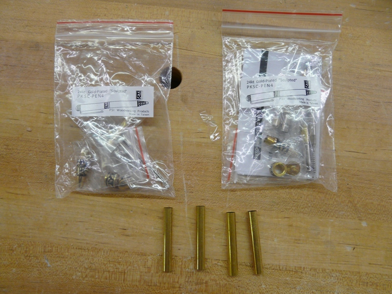

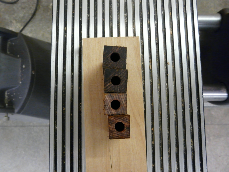

Now that we have the blanks drilled it is time to prepare the tubes.
[attach]12176[/attach]
Don't ask how I know this but it is better to remove the tubes from the kits and reseal the packet so that you do not discover later that you have lost a part and now have a useless $10.00 pin kit on you hands.
[attach]12177[/attach]

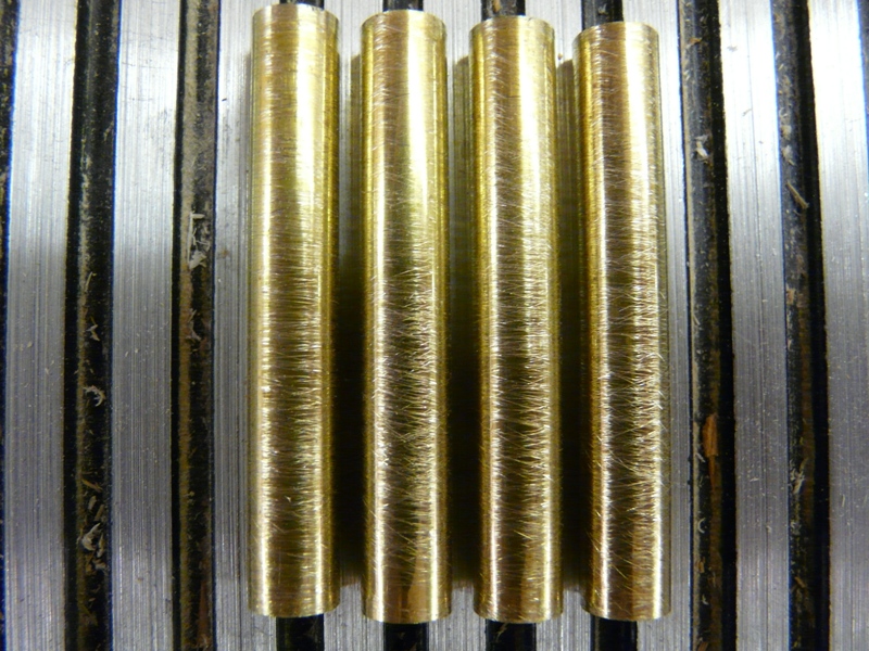

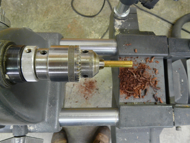

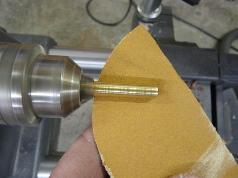

To prepare the tubes to accept glue better I chuck them one end at the time in a drill chuck lightly hand tightening
[attach]12178[/attach]
and sand lightly with 80 grit paper.
[attach]12179[/attach]
Now up to this point can anyone argue that the Mark V is not the best pen lathe ever.

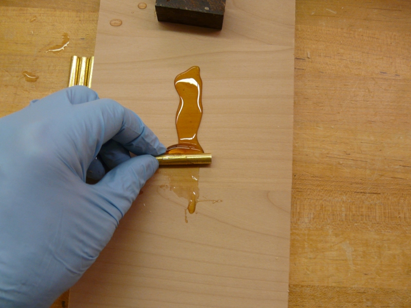

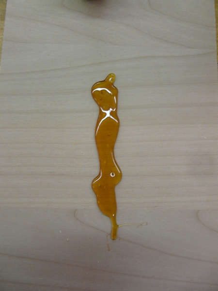

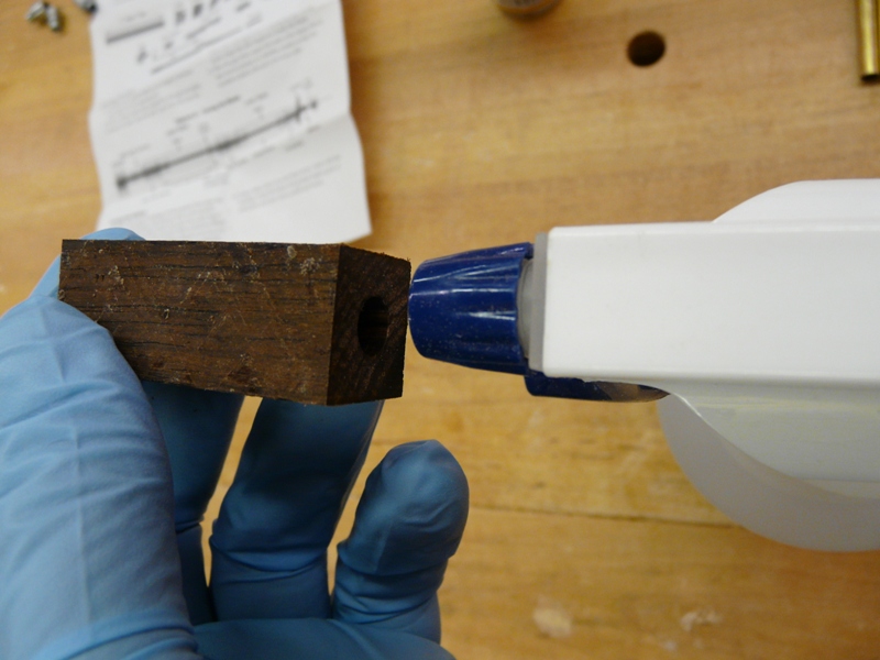

I use Gorilla glue to glue the tubes into the blanks.
[ATTACH]12183[/ATTACH]
I spread a bead onto some scrap wood.

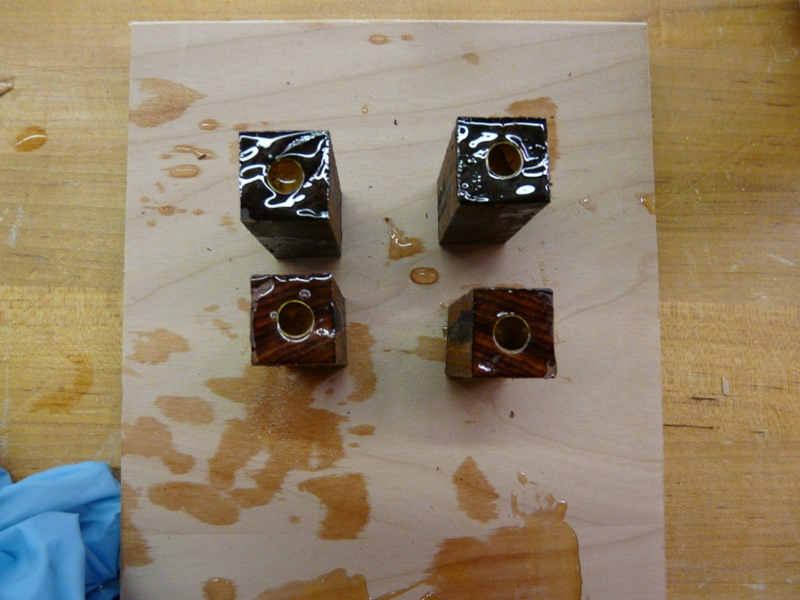

[ATTACH]12184[/ATTACH]
Gorilla glue needs moisture to work so I squirt some water into the holes in the blanks and set them aside.
[ATTACH]12185[/ATTACH]
Then one by one I roll the tubes in the glue and insert them into the blanks.
[ATTACH]12186[/ATTACH]
This will be a mess in a few hours. I like to glue them up at the end of the day and allow them to dry over night.
