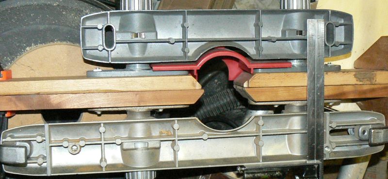

Is there something to learn from the drawing that is not obvious by simply looking at a 510 table?SDSSmith wrote:The shaper fence can also be modified to fit the newer 510/520 tables. Shopsmith provided me with a diagram for drilling two holes to allow bolting the fence to the table through the two holes in the 510/520 table. Now if I could only remember where I put that diagram.
SS parts recognition test
Spacing is one thing, location(s) is another. I will look at a 'set' and come back after trip to grocery!dusty wrote:Is there something to learn from the drawing that is not obvious by simply looking at a 510 table?
Where would you put the 'holes'?
[ATTACH]12656[/ATTACH]
Not as simple from this vantage point!;)
- shaper fences.jpg (91.18 KiB) Viewed 1763 times

I would also be interested in the hole locations.
When I upgraded to the 520, I tried to see where it could be modified, but it didn't seem possible. What I did was to use T-nuts to secure the fence, but this puts it too far back, so I mounted 1-1/4" thick spacers to push the fence forward. Not my idea - I think I found it on the forum.
Michael
