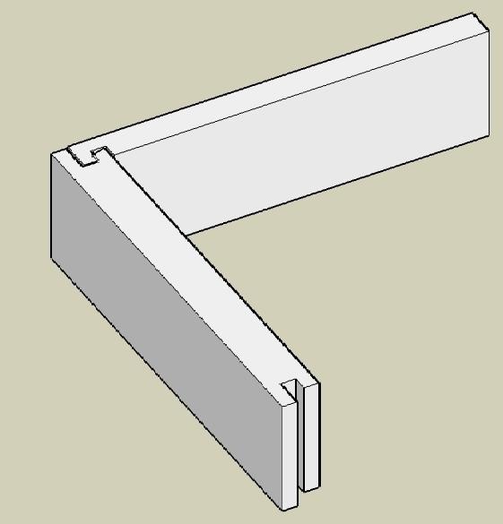

It has now dawned on me that I referred to the drawer joint in Post #6 as a dado and tongue. It would have been more correct to refer to the joint as a dado and rabbet. Gotta admit I was thinking of the 1/4" insert as a tongue. Actually it is just the part of the board left over from the rabbet. I guess a true tongue is made by making two rabbets.
As long as we are talking about drawer joints, there is also the locking dado, or double dado joint.
[ATTACH]12745[/ATTACH]

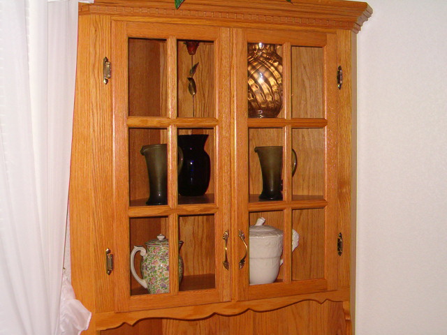

Stiles are vertical - rails are horizontal - mullions are structural pieces that separate elements - maybe you were thinking of muntins. A muntin separates the "lites" or panes of glass. They are also called grids, glazing bars, etc.
These doors are structurally sound with the vertical stiles and horizontal rails. The horizontal glass separators are muntins. So are the shorter vertical ones.
[ATTACH]12746[/ATTACH]
double dado drawer joint.jpg (20.01 KiB) Viewed 6663 times
I was thinking of a paneled door, however I have tended to refer to all three(stile,mullion,muntin) as stile(bad habit caused by early ignorance).
Thank You for forced late understanding.
