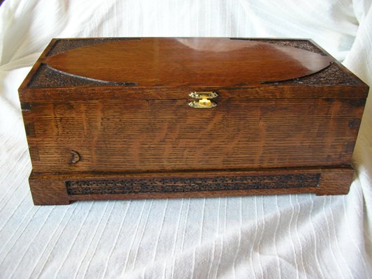

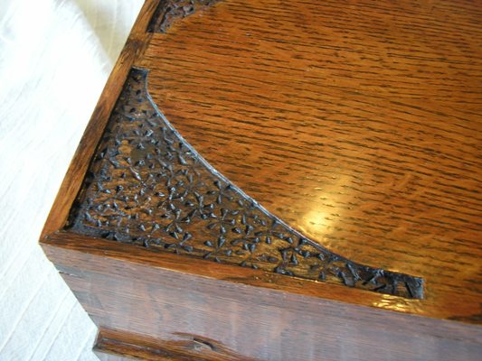

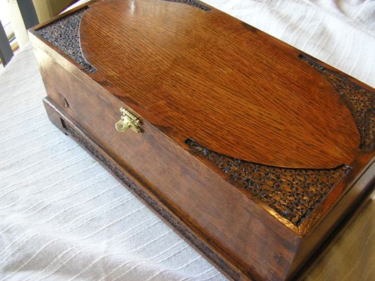

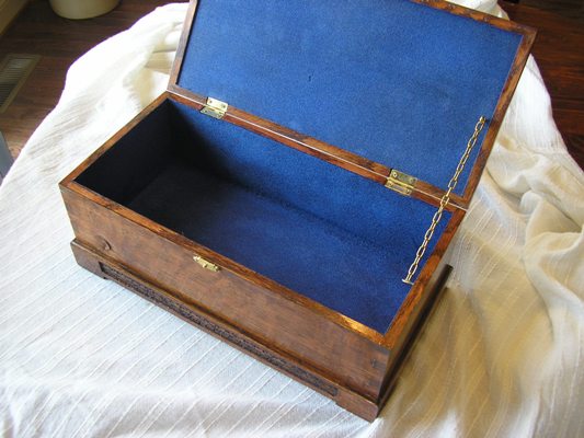

Here's the project just about completed:
4 coats Poly. Then rubbed out to 1500 followed by automotive rubbing compound then car polish and finally wax.
[ATTACH]13412[/ATTACH]
[ATTACH]13413[/ATTACH]
Black and brown shoe polish left to dry in the dimples. Then waxed carefully. Wax will pull the shoe polish out.
[ATTACH]13414[/ATTACH]
Left some shoe polish in cracks to age the piece a bit.
[ATTACH]13415[/ATTACH]
Where did the shopsmith come in? It's the front dimpled area on the front of the piece along the bottom. I double sided taped the entire piece assembled onto my jig (a flat piece of mdf that has a piece that rides in the miter slot. I then mounted a router bit 3/16 size into the router chuck and used the table height lever and sliding the jig along the table to get a perfect square rout of perfect depth. I couldn't have done it another way unless I routed before I cut the wood.

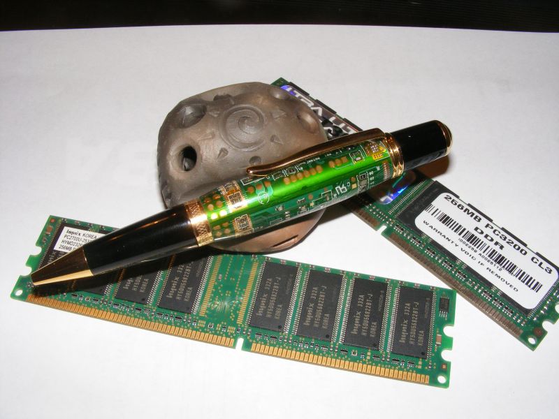

Went to the woodcarvers show yesterday and my wife saw a circuit board pen for sell and loved it. I had not turned one of these yet so instead of buying one made went to woodcraft to pick up a kit, also found several other items I could not live with out and turned her a circuit board pen this morning. Also found that woodcraft is carrying sinken cypress and picked some of that up to turn. I saw it carved and turned at the show and the finish was really nice so think I will try a pen tomorrow. Will post it to let you see how it turns out.

Bill... that pen ROCKS!!! As someone who works with computers a LOT, and has seen his fair share of the insides of a PC case, I found the next thing I must have!!! :D

I like the jewelry box especially the dimpling or detail in the top. I'm wanting to make a toy box with detail like that. I've always wondered how that was done and now I know. The question I have is in regards to the circuit board pin. How did you get it to wrap or turn? Did you heat up the circuit board and formed it around a pen shaft?
