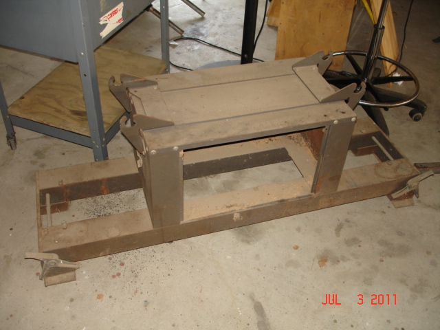

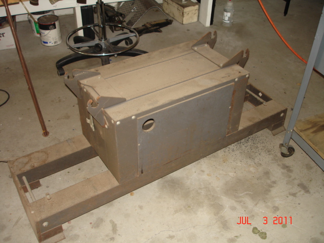

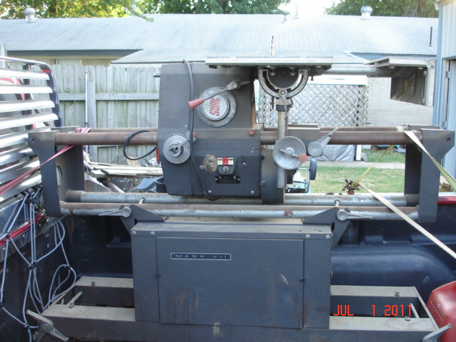

Key question - Did you get the base also? The part the bench tubes mount/pivot on.
Good news, the infamous melting plastic cam appears in good condition. I believe the follower has separated from the control sheave and that rendered it inoperative.
He has the base, its in the lower right background of one of the photos.JPG40504 wrote:Key question - Did you get the base also? The part the bench tubes mount/pivot on.
damagi AT gmail DOT com
I went back and discovered that after noticing what appears to be a cover in one of the other pix.damagi wrote:He has the base, its in the lower right background of one of the photos.

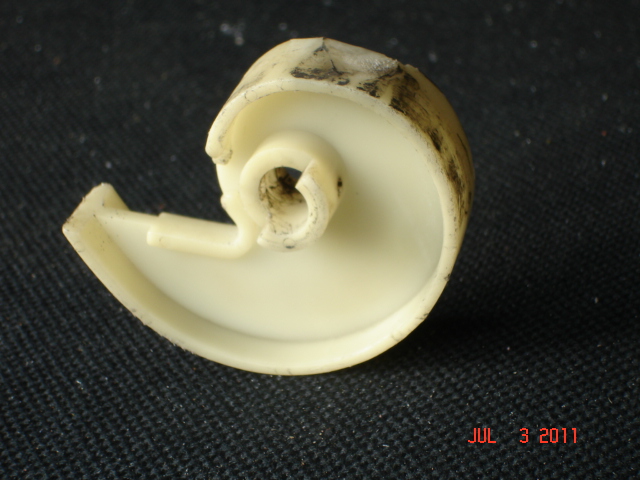

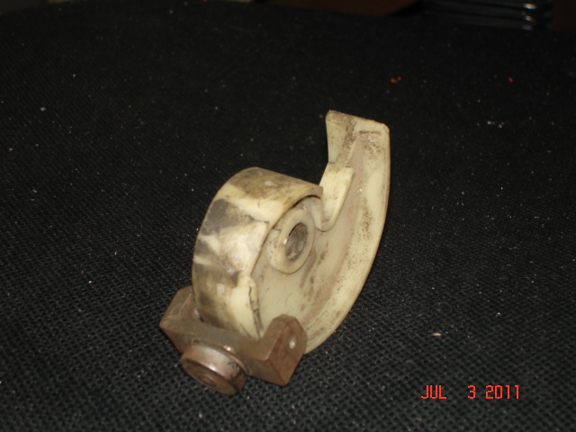

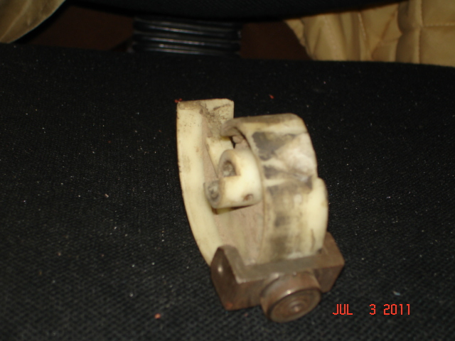

Question is, why is the control cam not on its shaft, and can it be put back on.
Yes base doesn't appear to be to bad but will need to paint also
A few more pics of cam too

Looks like the camfollower is still attached to the control sheave 'snout' bearing(good news).iaokie wrote:Yes base doesn't appear to be to bad but will need to paint also
Send me an e-mail and I will reply with a Mark VII parts manual in pdf form.
your cam looks workable, but is damaged from what I can tell.iaokie wrote:Yes base doesn't appear to be to bad but will need to paint also

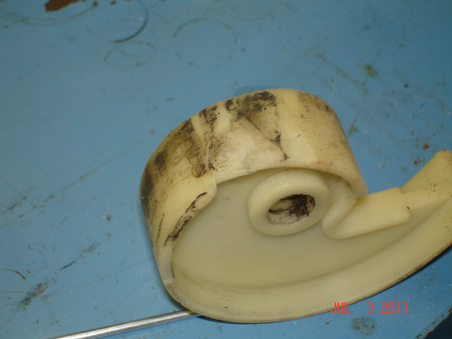

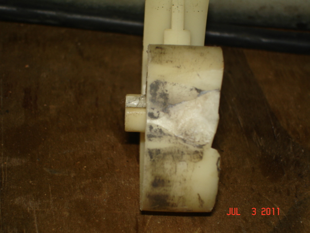

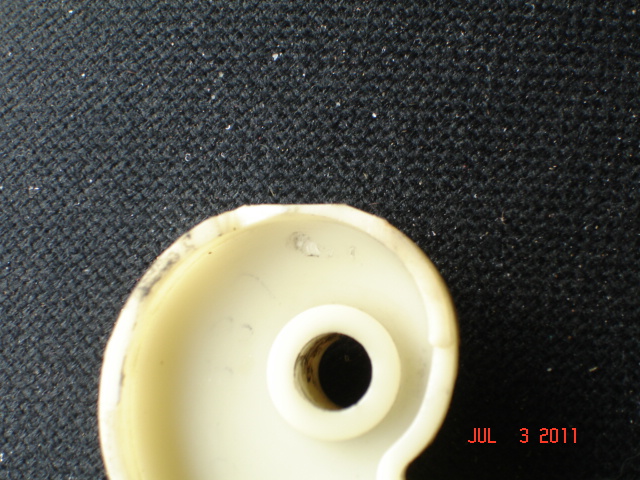

Took a few more pics after I cleaned the dirt off
Nothing is cracked but I can see where it is worn some what flat in one area
and a small piece is gone from the edge
- DSC02408.JPG (150.66 KiB) Viewed 1469 times
- DSC02407.JPG (153.81 KiB) Viewed 1428 times
- DSC02406.JPG (125.69 KiB) Viewed 1424 times
- DSC02405.JPG (131.82 KiB) Viewed 1426 times
The problem is that missing chip on the side, which could easily cause the follower to bind/buck/shatter. Since the follower is hooked up to a bearing on the sheeve, if the bearing goes bad then it puts a huge ammount of stress on the plastic cam.iaokie wrote:Took a few more pics after I cleaned the dirt off
As I said, you might be able to get by, but its unclear for how long without a fix or replacement. You might be able to fix it by putting some very thin material around the inside/outside (perhaps aluminum from a beverage can) and then filling in the chipped part.
