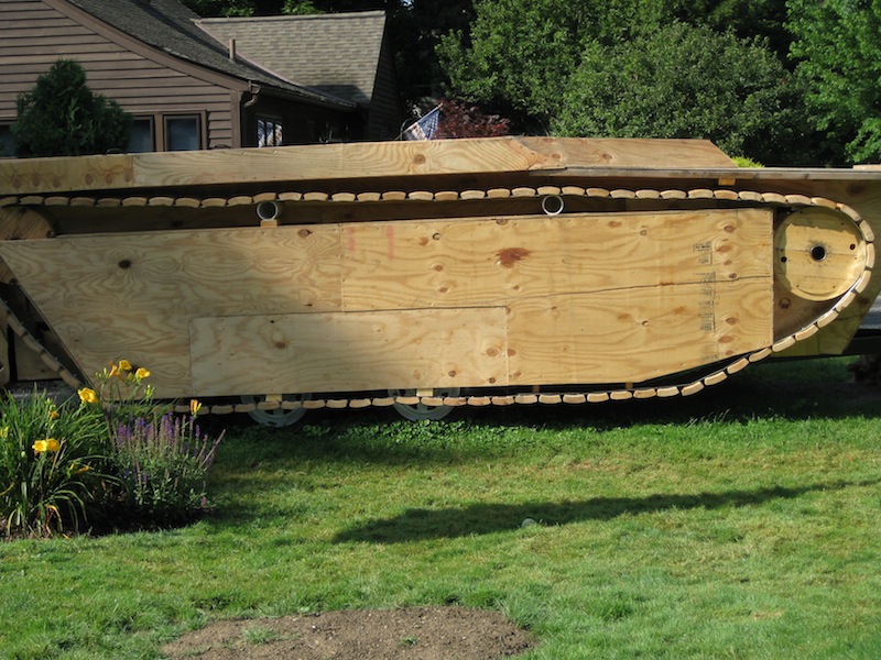

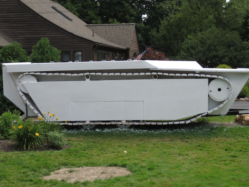

Here are a few updated pictures of the framing. The first pictures shows the treads completed. I cut 2 inch treads on the bottom to go in front of the tires. It completes the look and from 20 feet away you can't really tell.
[ATTACH]13657[/ATTACH]

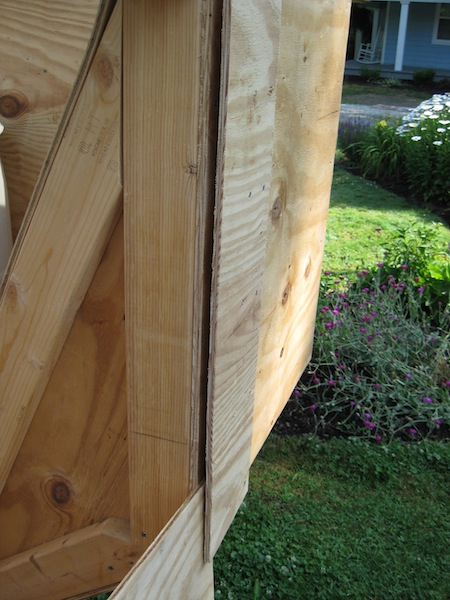

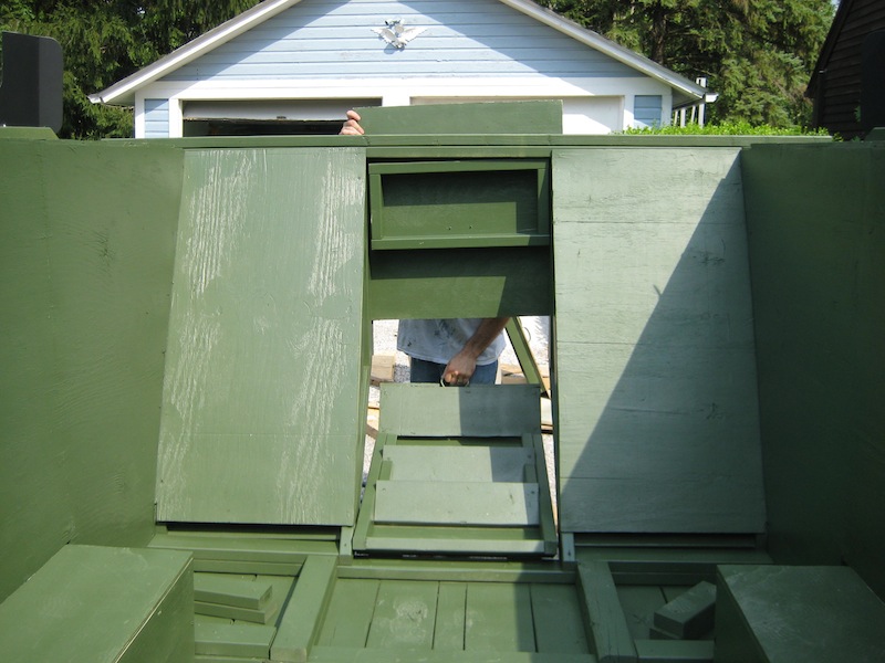

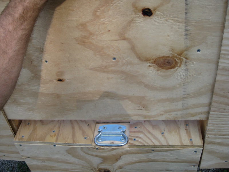

the next series of pictures is from the entrance to the float. I created steps that hinge down. The top board slides up to release the steps and then slides all the way down and out to create the opening. When locked in place. it would be rather difficult for one of the kids to accidentally open the door and fall out.
I built a channel that the top piece slides through and it overlaps the steps by 8 inches creating a friction lock.
[ATTACH]13658[/ATTACH]

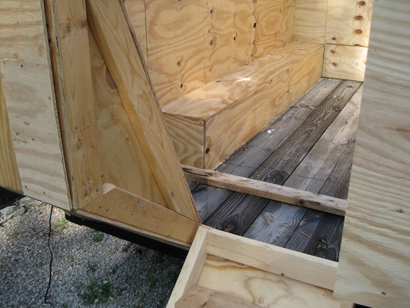

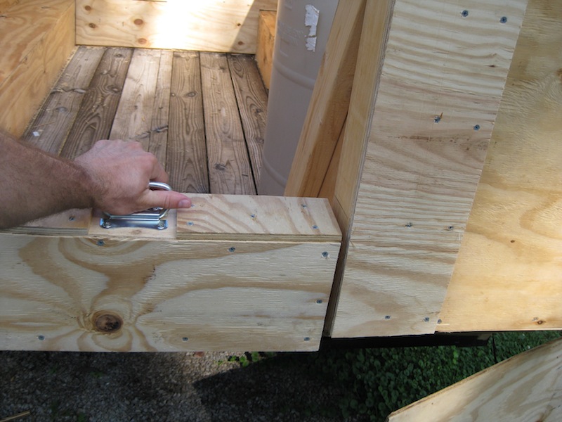

Here is one more picture of the slide lock. There is 2x4 framing on the inside preventing it from sliding down all the way while the steps are up. The 2x4 rests on the top of the steps and holds it all in place.

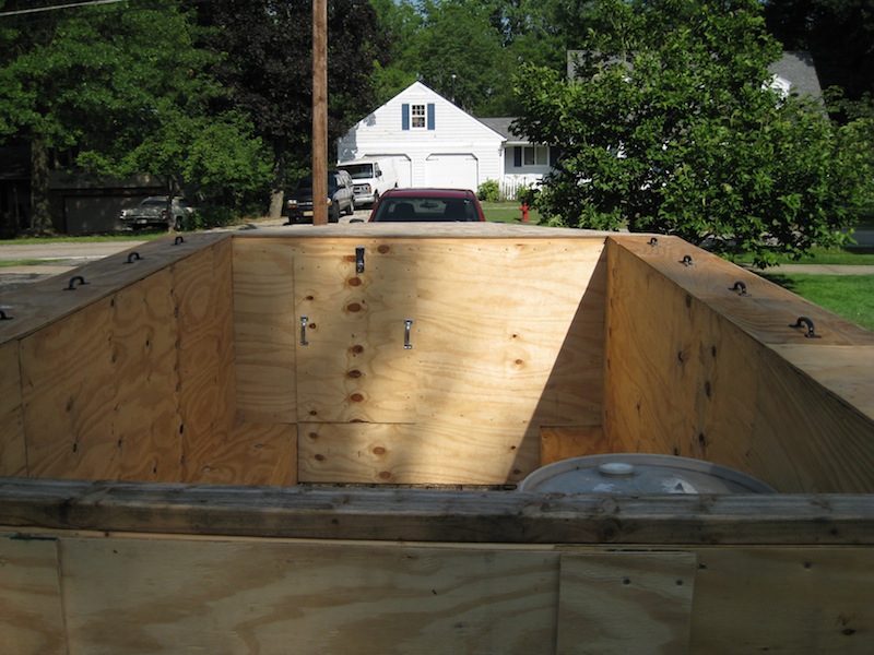

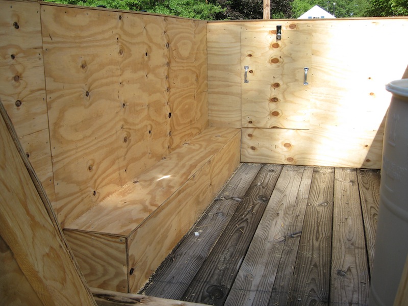

Then here are a few pics of the inside of the float. The Young Marines wanted the inside to look the realistic as well which meant I had to cover up all of the 2x4s with plywood and I had to frame in the whole thing without angle braces off the floor. This made life difficult to say the least.

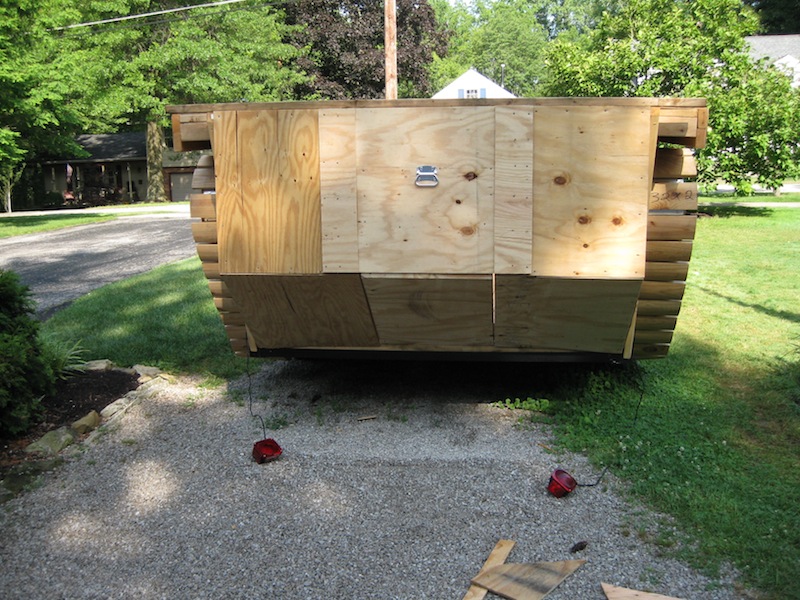

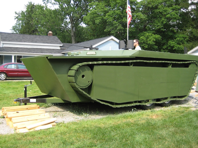

Updated pictures of the float
[ATTACH]13727[/ATTACH]
[ATTACH]13728[/ATTACH]
[ATTACH]13729[/ATTACH]
[ATTACH]13730[/ATTACH]
[ATTACH]13731[/ATTACH]

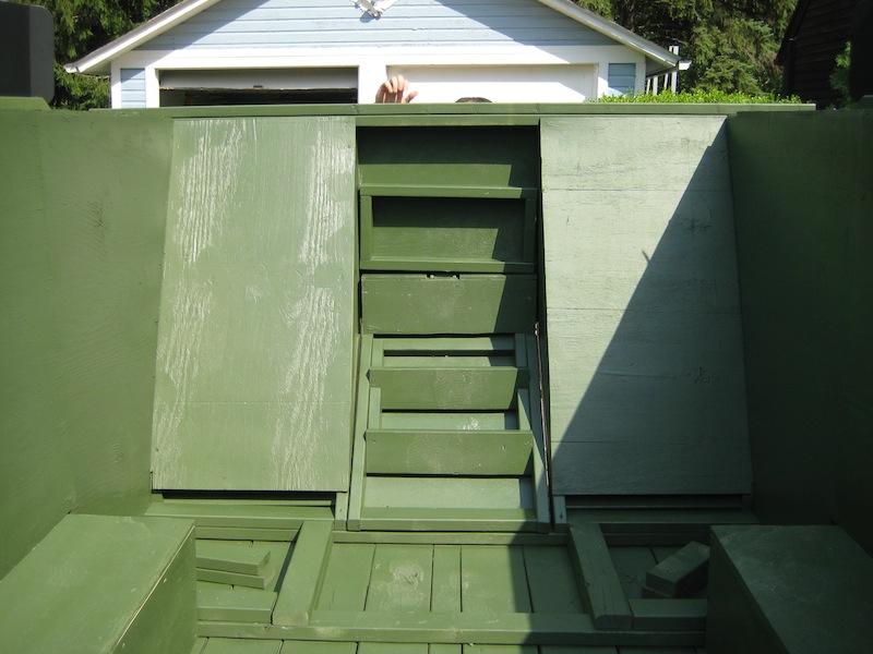

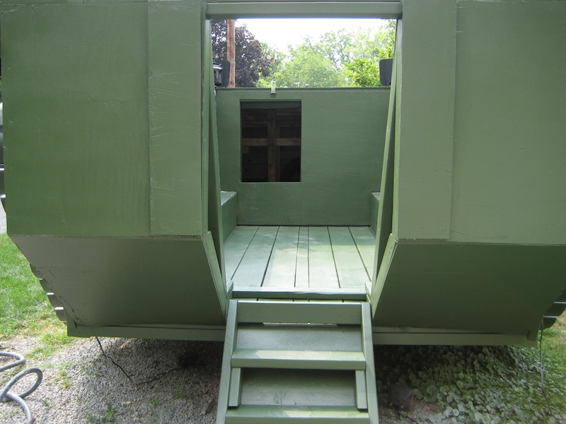

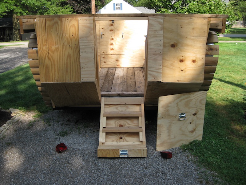

Here is a few of the door / steps in the back of the float open and closing and closed.
[ATTACH]13732[/ATTACH]
[ATTACH]13733[/ATTACH]
[ATTACH]13734[/ATTACH]

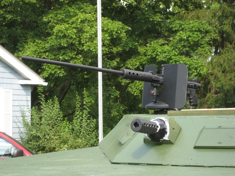

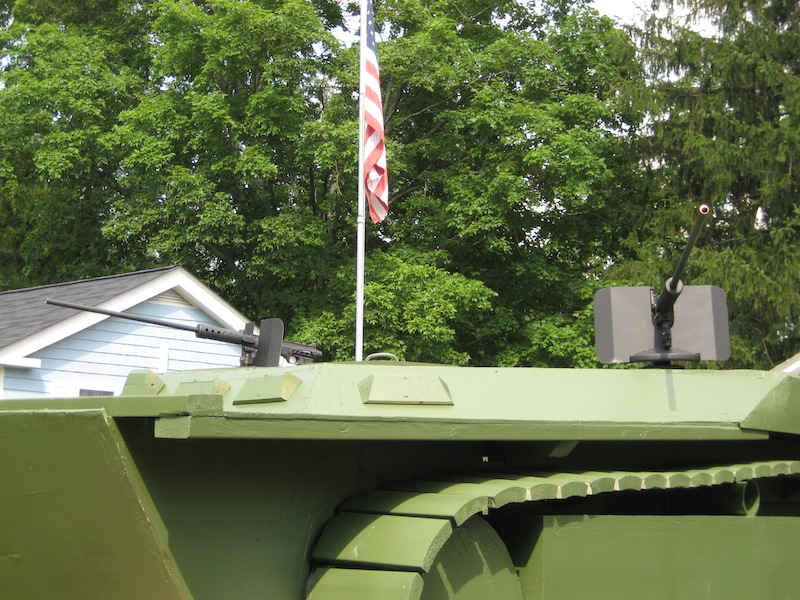

Also a small turret on the front just added. This one is stationary and can not fire.
[ATTACH]13735[/ATTACH]
