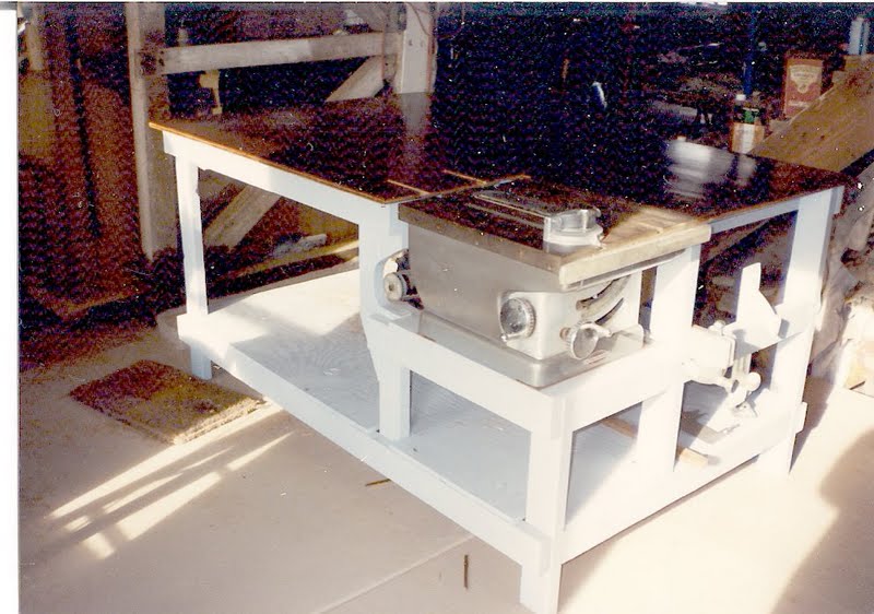

This saw with a 4' X 6' top was how I used to cut most sheet goods for some time. It evolved a little more after I took that terrible picture with a little throw-a-way instant camera (Polaroid type now banned). I am still flip-flopping on whether or not to move it to the new shop location and add a full length left side drop-leaf support. I did love that big table top.
I can still handle a full sheet of 3/4" plywood but they are gaining weight and I try to think open-mindedish about how I may need do things in a few years and get ready now.

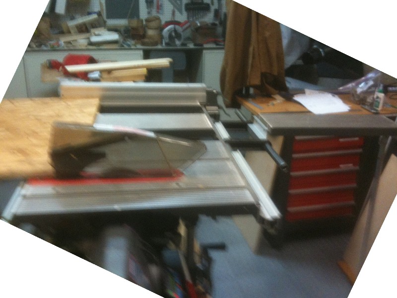

I tend to use my TS-3650 with wings for sheet goods but have also used my 510 with an extension table on each end and having a second SS with the saw table and 2 extension tables (no saw blade) sitting right behind the 510. The tables on the second SS are sat a bit lower (but not much) than the 510.

Cutting sheet cuts on the Shopsmith is not a bad practice. Cutting sheet goods when you cannot handle the material so as to"keep it under your control" IS a bad practice.
Cutting sheet goods on your small table saw is not, in my mind, an unsafe procedure. The sheet goods are supported. All you have to do is keep it against the fence "throughout all of the cut".
To accomplish this with the Shopsmith, I used an outfeed table and some in feed support that is no longer needed was the cut is underway.
I have had one bad experience ripping large items on the Shopsmith and that was caused by my inattention when something happened just outside the shop door. Look away (even for a split second) while feeding into the blade and all hell is likely to break loose.
I like your table design. I might have to make my own. I still have my first table saw (circa 1950s).
