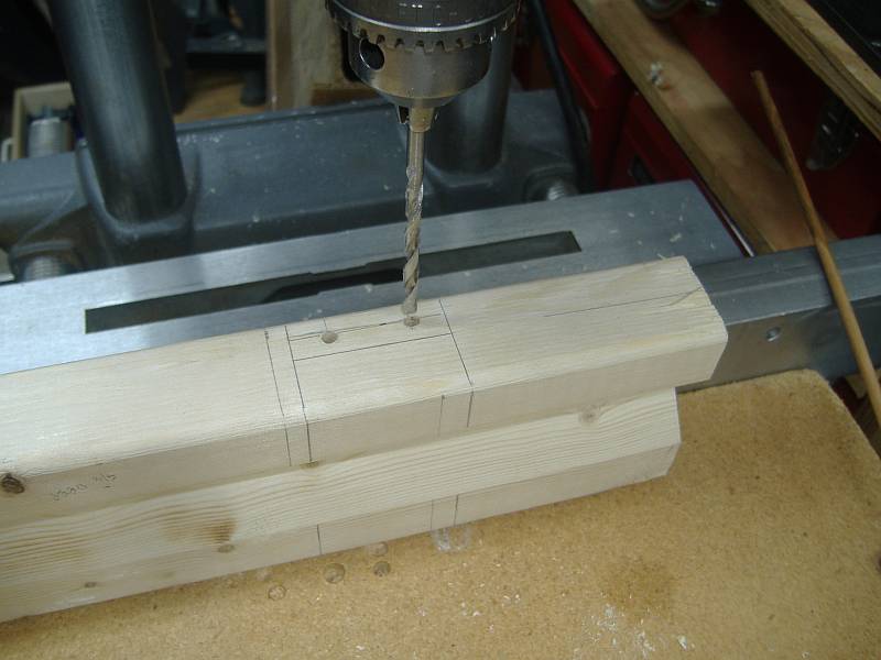

In this case I need to drill a hole though a piece of wood that is 3-1/2 inch thick. I need the hole to be 3/16" diameter and I'm using a stock twist drill that can not drill this deep. Bits vary in length, in my case this bit is end to end 3-1/2". By the time it is chucked I ended with about 2-1/2" drilling depth.
One option is to buy a longer bit, $, time and effort made me think no, I can use another trick and get to show you another way at the same time.
At today's start point the set up has been done, the fence is adjusted so all the holes will be drilled a set distance from there. The drill table is clamped in place so it can not move along the fence. I have drilled two holes as deep as I can with the bit I have.

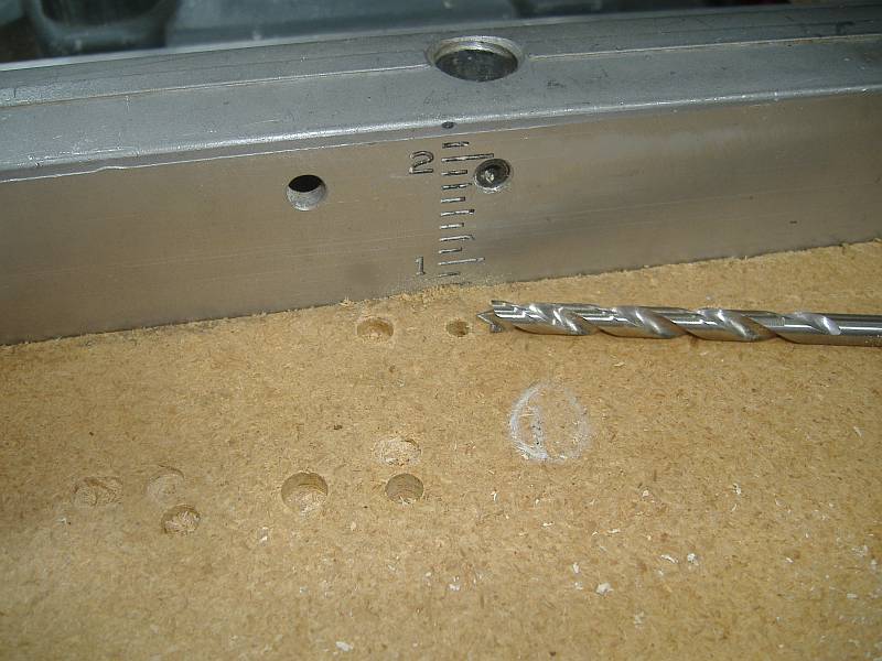

I have also used the bit to drill a hole in the drill table. The bit is pointing at the hole.

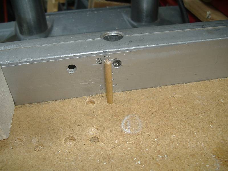

From my junk box I select a short section of 3/16 dowel to put in the hole.
[ATTACH]14247[/ATTACH]

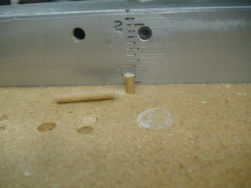

The dowel can now be cut down to say a 1/2" high. A bit of sandpaper to clean it up is a good idea, the picture shows it before that happened.
[ATTACH]14248[/ATTACH]

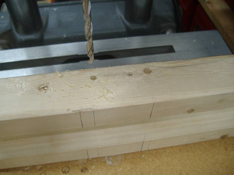

When the work piece is flip around make sure you keep the same side that was towards the fence is still facing the fence. You fix the other hole position by sliding the work piece hole over the dowel. You are now controlling both front to back and side to side movement.
Drilling the holes should align very well now because they are centered. You need only drill until you feel the first hole.
