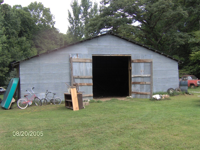

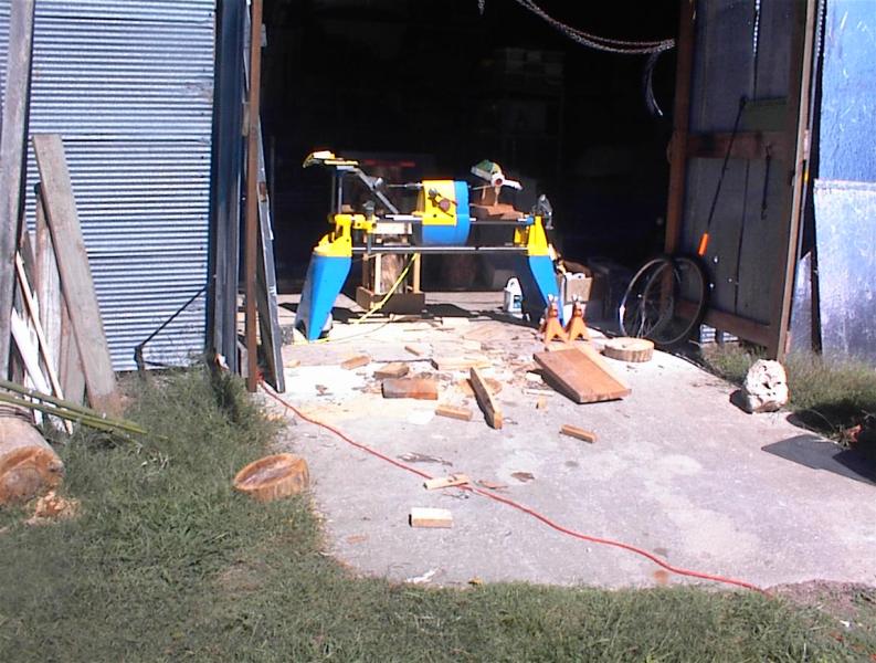

This "shop" started life as a fish hatchery next to the springs behind our house, sitting on a sloped concrete floor with a drainage channel down the middle. When the fish business dried up (so to speak), it was pulled up on dry land and used as a hay barn for years. Then the cattle business drifted off, and it became a storage building for many more years. My dad was about to tear it down because he didn't like looking at it in front of the house, but I convinced him to let me use it. I scraped out the floor of hay, manure, dead stuff, junk, and rocks, levelled it up and poured a concrete floor, repaired the leaking roof, killed out the termites before they brought it down, and moved my car stuff in. The barn/hatchery/shop is only 20 x 40' so I'm not sure that really qualifies as a barn as much as an outbuilding or large shed, but it's what I got and I'm thankful for it.
