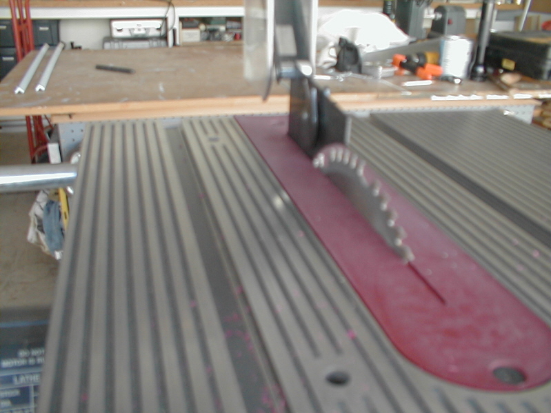

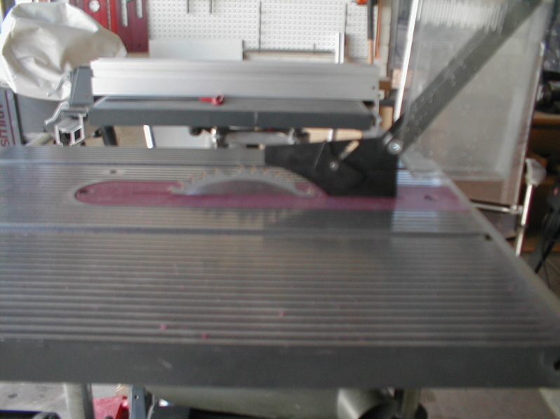

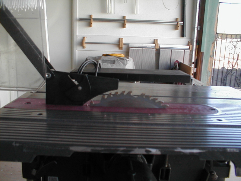

Ed in Tampa and Jim in Tucson - thank you for those inputs. I believe they have resulted in a safer work area for me.
I have followed your example and modified one of my zero clearance inserts so that it can be used with the upper saw guard installed.
After the first of the year, I WILL GET A BETTER DIGITAL CAMERA - promise.
Riving Knife & Zero Clearance 1.JPG (192.22 KiB) Viewed 14291 times
Riving Knife & Zero Clearance 5.JPG (200.92 KiB) Viewed 14292 times
Riving Knife & Zero Clearance 6.JPG (186.46 KiB) Viewed 14285 times

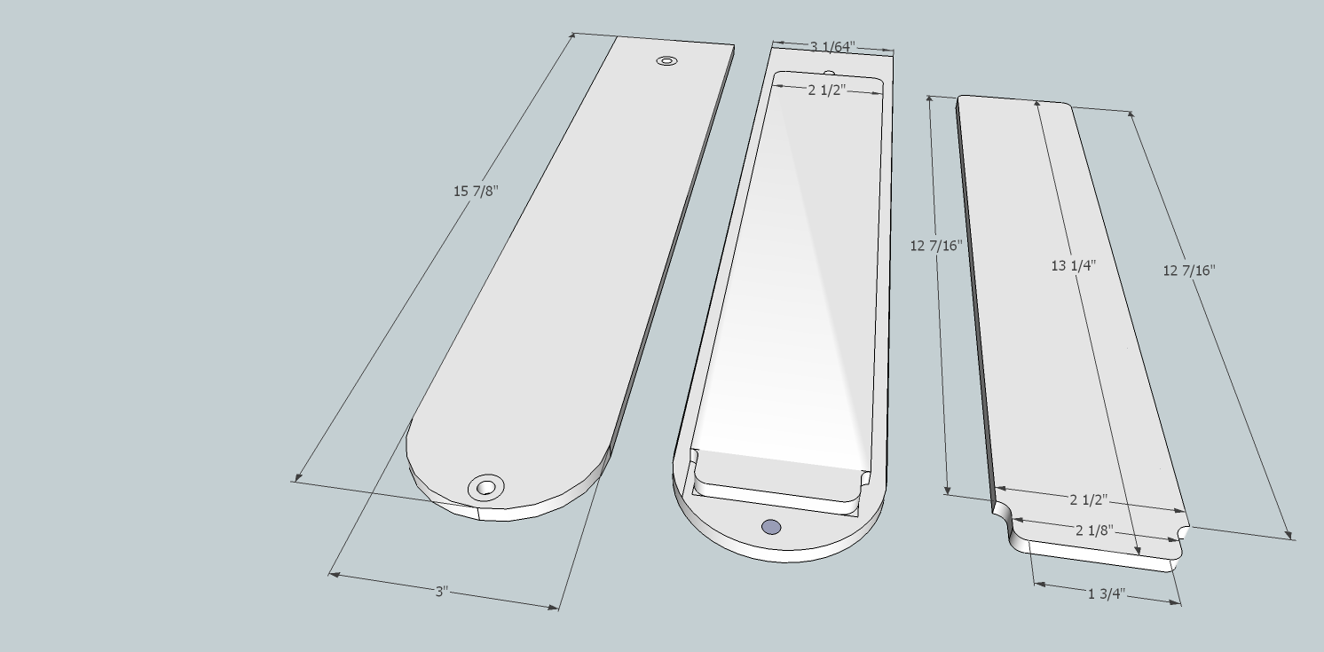

A Top and Bottom Views of ZCI Redesign.png (60.32 KiB) Viewed 13895 times

Thanks for the schematic Dusty and thanks Gary. I might just take 1/4" stock and cut it to size and use a smaller 1/4" stock and glue to middle to give it a bit more structure.

I do most of the work on this part of the ZCI on a table router. One of the drawings here is the template which I put on with two sided tape. The two outside edges are simple 1/4" insets which I cut first. That established the location of the template.
Be aware - when I make these I do a dozen or so at once; a bit of a small production line approach.
