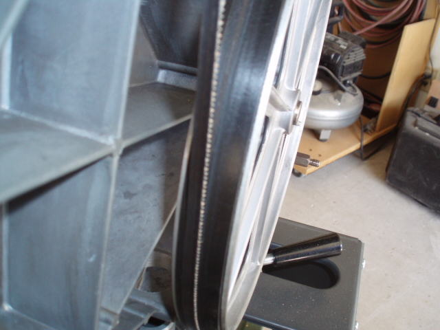

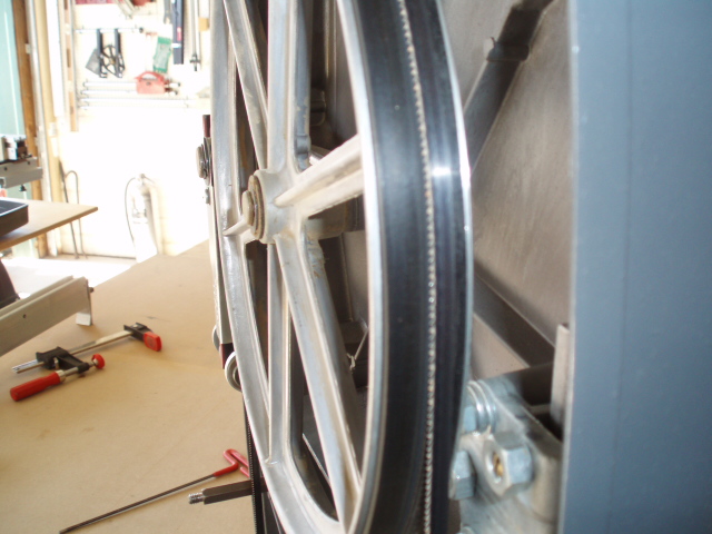

Derek: do you have a Shopsmith bandsaw? If you do and the blade is tracking in the center of the tires - you have a tracking problem! The Shopsmith tracks toward the rear of center due to the way the upper bandsaw wheel is cantered.derekdarling wrote:And another thing, very important as I have found out... is the blade tracking EXACTLY in the middle of the tires? I was ripping about 6 degrees off until I heard about this trick. Centred the blade on the tires and the skew went to 0 degrees.

Dusty, I do not, but thanks for setting me, and others, straight about the ShopSmith bandsaw. I have a delta-clone 14", and had quite a tracking problem until I centred the blade... cleared it up in a jiffy!dusty wrote:Derek: do you have a Shopsmith bandsaw? If you do and the blade is tracking in the center of the tires - you have a tracking problem! The Shopsmith tracks toward the rear of center due to the way the upper bandsaw wheel is cantered.

derekdarling wrote:Dusty, I do not, but thanks for setting me, and others, straight about the ShopSmith bandsaw. I have a delta-clone 14", and had quite a tracking problem until I centred the blade... cleared it up in a jiffy!
Derek
This exemplifies the reason we ss bandsaw owners must be careful regarding advice that does not apply to the unique design of our bandsaw.
It is truly a different animal from most others.
Follow ss directions! And those of 'us' who understand that animal!
