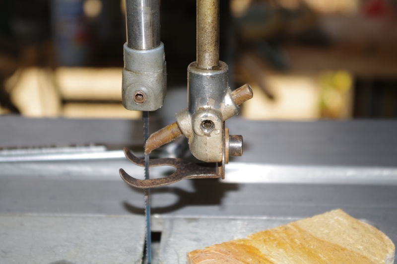

Here's another question: I just got my scroll saw running tonight. It has some sort of sacrificial material that acts as a blade guide/cooling block. Mine barely moves in the shaft, I suspect because of age turning it brittle. Is there a replacement source out there?

Whoa! Easy on the criticism of my baby! The jig/scroll saw is running fine. I'm just wondering about this little backing cylinder that was hard to adjust because (I think) it has outlived its pliability. I'll post a close-up pic when able.

- Close-up of cooling block/blade guide that is acting stubborn
[ATTACH]14878[/ATTACH]

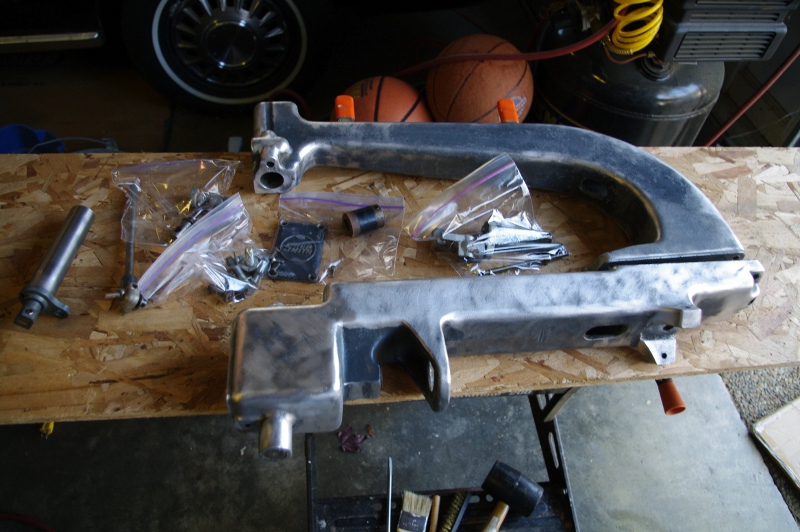

- Picture of stripped jigsaw
[ATTACH]14879[/ATTACH]

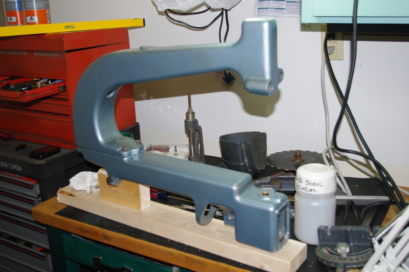

- Picture of painted jigsaw
[ATTACH]14880[/ATTACH]
I used the self-etching primer someone here recommended, then Rustoleum hammered finish light blue. I was already a fan of the hammered finish paint. I'm really pleased with the way it came out. With the weekend done, not sure how soon I will have it reassembled and running again.

That 'cooling block' is a phenolic like rod that backs up the blade. The groove is either due to wear or a po cut it intentionally.
Great paint job etc.!

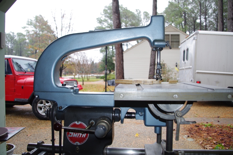

Scrollsaw up and running again
Post by chipmaster »
The saw is running much smoother after all the internals were cleaned, in some cases polished, and oiled with sewing machine oil.
[ATTACH]14917[/ATTACH]
