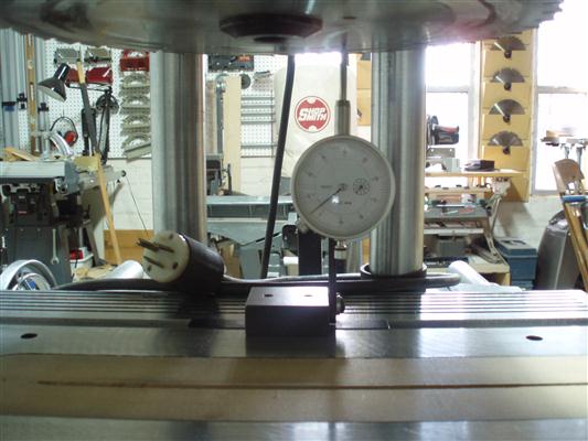

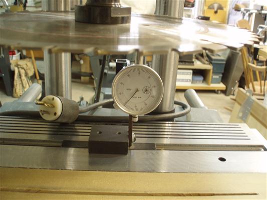

My preferred method for checking wobble (don't think that is a proper term for runout) is shown in the next couple images. The wobble on this arbor/blade combination is .003"-.004". I don't know that I have had better.
[ATTACH]15078[/ATTACH]
[ATTACH]15079[/ATTACH]

a) I have a dial caliper on my list of wants. That's definitely the method that makes sense to me.
