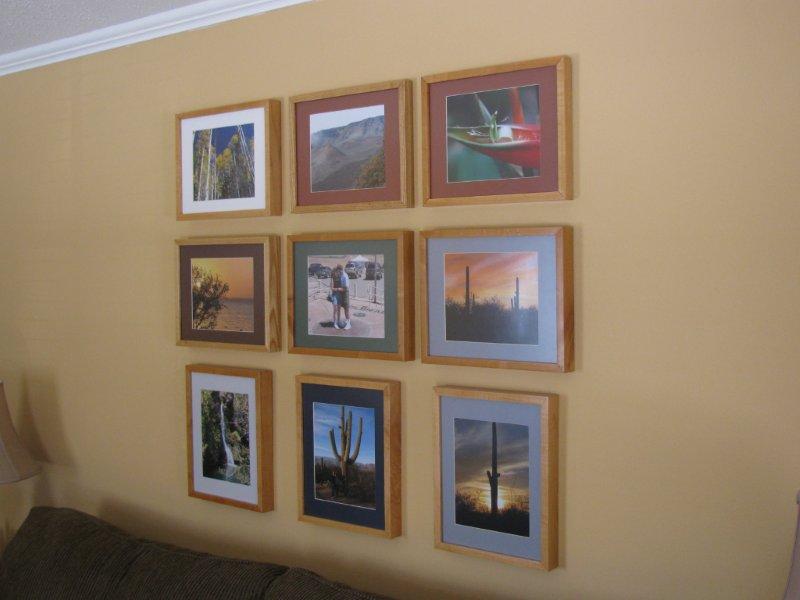

Here's a collection of basic frames I've built over the last 6 or 7 years to display our travel photos at home. All of these, with one exception are what I call gallery frames....kind of a reversed shadow box type construction. While not every corner is perfect.......
All of the prints in these are 8x10s (kinda give an idea of overall size)

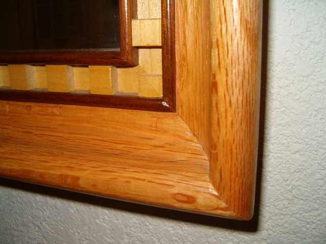

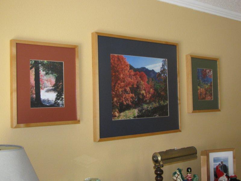

The center one is a 16x20 print
[ATTACH]15082[/ATTACH]

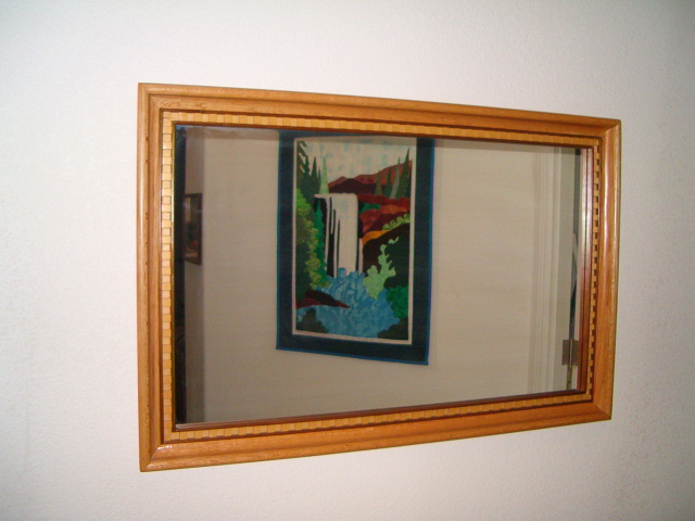

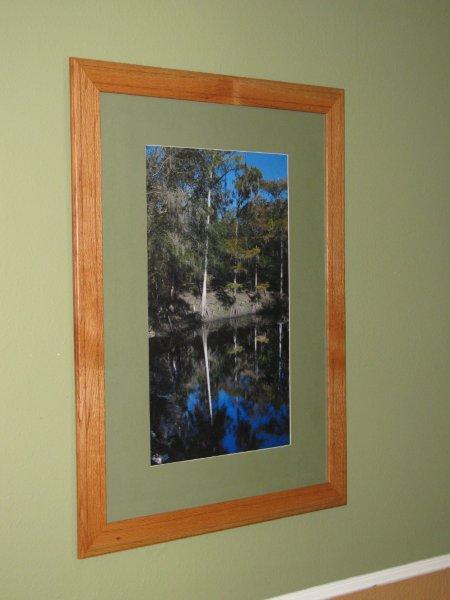

This is a more 'traditional' frame with outside dimensions of about 33x43"
[ATTACH]15081[/ATTACH]

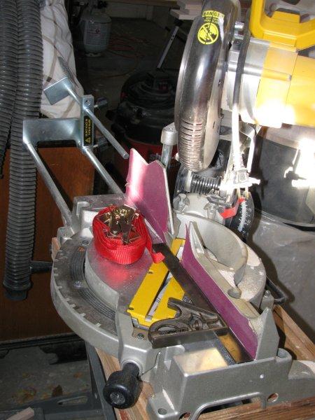

Here is my collection of critical frame building tools. The MOST important tool of the bunch is my ancient Starrett combination square.
[ATTACH]15080[/ATTACH]
I guess the length stop on the far end of my miter saw would have to rank right up there with the Starrett. If the opposing pieces ain't IDENTICAL lenghts....it ain't gonna be square. Not shown is my 510 with the jointer attached to get the straight edges required, and my lunchbox planer to get all the stock to the same thickness.
One thing I've learned about getting identical lengths using the stop is to try to use the same force on each piece when butting the first mitered end against the stop. The softer the wood, the easier it is to smush the soft point of the outside edge and get a longer piece. I'll also do a test frame from scrap stock as described by pennview:
pennview wrote:.... I use a scrap frame and make test cuts until the angle is exactly 45 degrees. This means trimming the end of each piece in the frame for a total of eight cuts. If the angle isn't right, tweak the miter gauge and then make eight additional cuts until the angle is perfect.
The band clamp is also a wonderful invention. I make sure I use the corner supports to keep from smushing the outside corners and try to not over tighten to avoid springing the frame pieces out of square. Another thing to check after tightening the band clamp is to make sure all sides of the frame are flat on the bench surface.

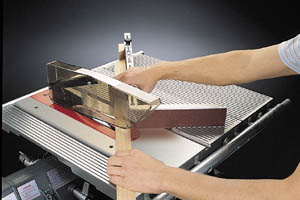

My self? I use a Shopsmith MiterPro http://www.shopsmith.com/ownersite/catalog/swd_miterpro.htm and saw the right side of each angle with the long leg and the left side of the joint with the short side. Result is a perfect 45.

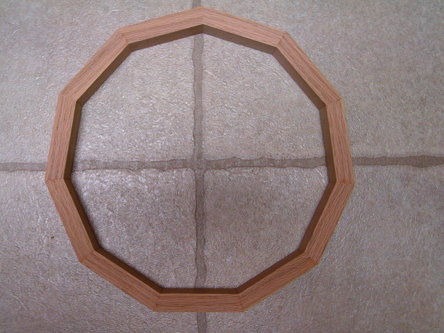

For more than 8 sides I love the MiterSet! Here is an example of a trial to make an 11 sided frame using the MS.
[ATTACH]15087[/ATTACH]

charlese wrote:Special tools and jigs are fun to use and do the job well, but have you ever thought of how old timers - before these tools were invented made their accurate miters?

mrhart wrote:I don't understand the process here, try me one more time, I have the miter pro, have not used it yet.
[ATTACH]15089[/ATTACH]
The photo is from the Shopsmith page - The user is using the long leg. The short leg is near the operator. If the mating cut has been sawn from the short leg, the miter will be exact 45 deg. (sorry I had referred to right and left sides of a joint. I should have said mating joint surfaces)
Since the short leg has no stop block it should be used for the first cut. Then that miter can be placed in the angle of the stop block (as shown in the photo) before sawing the miter on the other end of a board. Continuing this process on 4 boards will produce a square frame. Adjusting the stop block for two of the boards will give a rectangle.
Note: the sandpaper faces of the MiterPro are used to prevent slipping.
