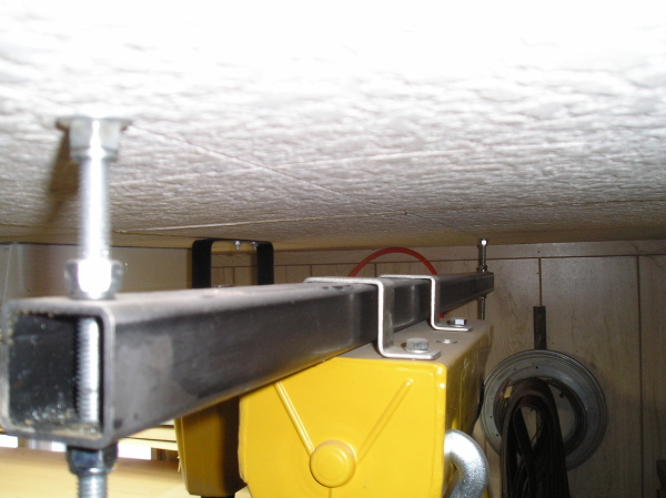

Paul, I will get back to Ed's home and ask him, and have a look at the bar on which this hoist rides on, even take a picture for you by this weekend. Cheers Dougpaulmcohen wrote:I have found cable hoists with 400 lbs capacity (much faster which I don't think is a good thing in this application) for well under $100 at Target, Sears... but can't find any information on the track or how to connect it. "Trolleys" I have found start at over $1,000 and can hold tons, of course not connected to my garage ceiling. It looks like Ed found something much cheaper.

Thanks, while you are there can you see how the hoist is connected to the bar and get a model for the hoist.

[]I sent more photos to Paul, and I guess I should have posted them here, anyway here is one showing it on the track 1 1/4 x 1 1/4 steel track 4 ft long as this is the lenght he need to move the bandsaw, from it's stand to the SS as he can move the SS back and forth or side to side. A larger and heavier track would give you a longer track to support moving it a longer distant. Cheers Doug [ATTACH]585[/ATTACH]

It looks like I better start looking for a winch and a way to hang it on a track in my garage (woodshop, that is). I am fast approaching the time when that extra help may be required.

And there is another way for those that don't have $100 handy, or don't have a handy electrical outlet. http://www.cvfsupplycompany.com/hanpowpulcom.html
Come alongs should be available at places like Harbor Freight or Sears, but, couldn't find one in a quick search. A 2 ton come along only costs around $30 or less. The one for $12.95 should get the job done just fine. That's really enough if you want to lift your Mark V or an auto engine.
Or you could use a simple block and tackle set up. You could even make the pulley blocks out of wood.
