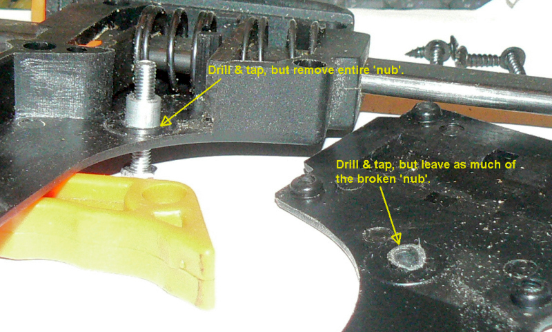

I bought one of these for the $1.99 price. Wanted to buy more but they only had one. When I got it home I realized why that one was not sold. There is a simple design failure. I will use my rain check and go back and get some more however because I can't find a clamp that good for $2.25 ($1.99 + $.26 for the bolt) anywhere else.
For $2.25 it's a very good light duty clamp.
Apparently I'm not the only one who has done this (link previously posted)

Paul M

Yuuup
I agree with Paul, make the simple modification and they make a pretty good cheapo light-duty clamp for the money. But only if you catch them on sale. Now that I've read everyone else's fix, that sounds more like what I did. I just know that replacing one piece (the bolt) made it much better than the ones I haven't fixed yet.

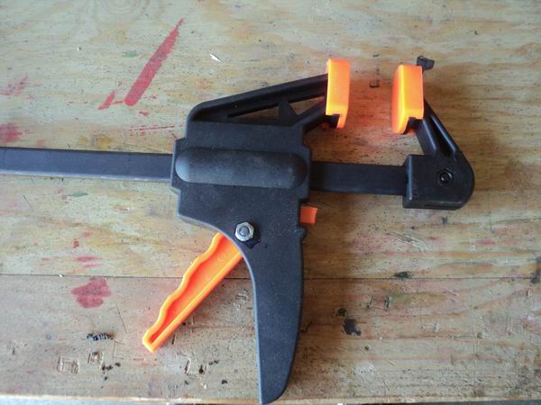

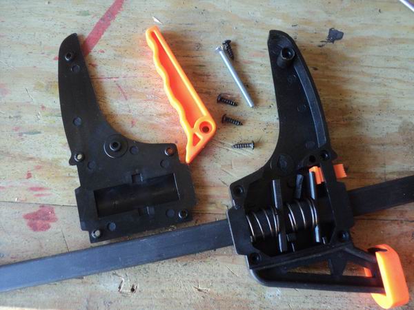

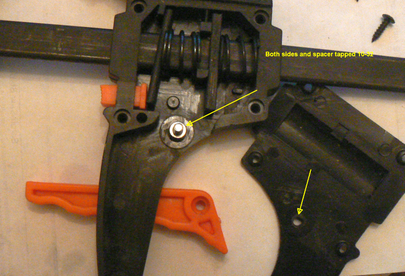

Clamp fix details ala jpg
Took a couple pix to illustrate what I posted earlier.
Main difference between what I did and others(bolt) was the inclusion of a spacer as a 'bearing' and tapped holes.
[ATTACH]15871[/ATTACH]
