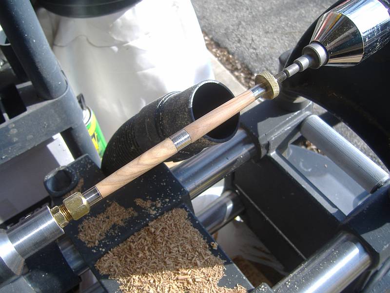

The next steps and then the pen.

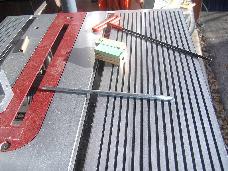

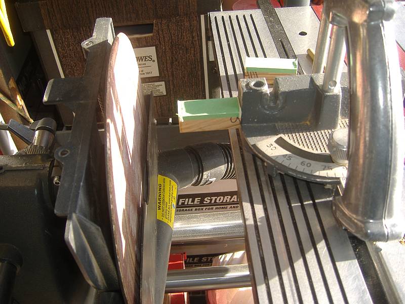

I opted to sand the blanks to size. To do this I cut a small section of 1/4" CRS then used the miter gauge to mount it.
This is what it looked like at the start.
[ATTACH]16002[/ATTACH]
[ATTACH]16003[/ATTACH]

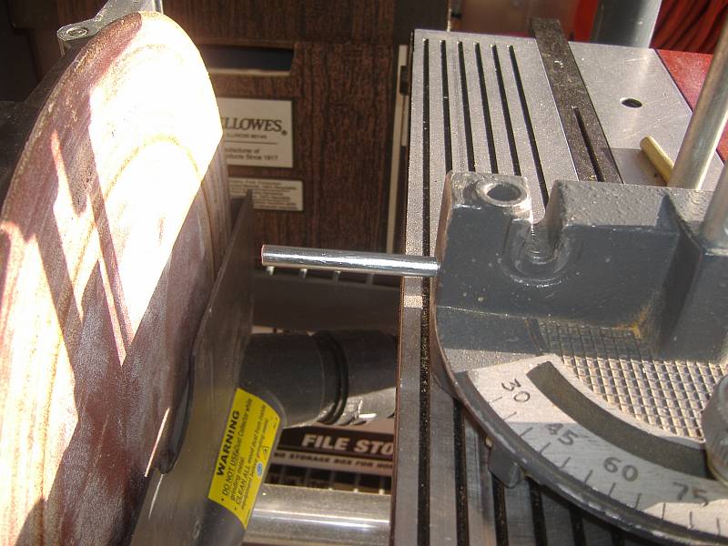

Made sure the rod would not come into contact with the sanding disk.
Sanding was done with the quill feed and the blank held in place. It seemed to work best at the middle top, anyway that was what I found.
[ATTACH]16004[/ATTACH]

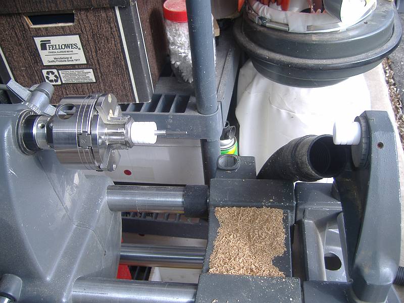

Basic turning and sanding were next. Once it was shaped and smooth I did a simple finish.
[ATTACH]16005[/ATTACH]

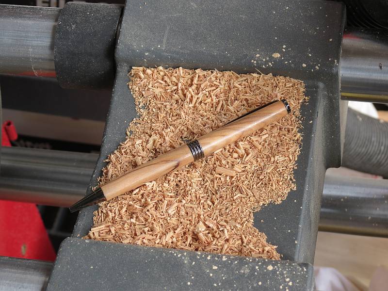

Pressed the parts together. One problem was when I was trying to put the pen tip in place, it just would not fit. I sanded a relief on the tip and used a a larger drill bit to help get it started. It finally went in but now there are 3 very small cracks in the wood. Going to have to look at this before I do another.
The press worked well, except for the pin tip issue.
[ATTACH]16006[/ATTACH]

Looks like the wife adopted the pen. She is using it to writer her sister a note/letter.
I'm reasonably happy with it.
