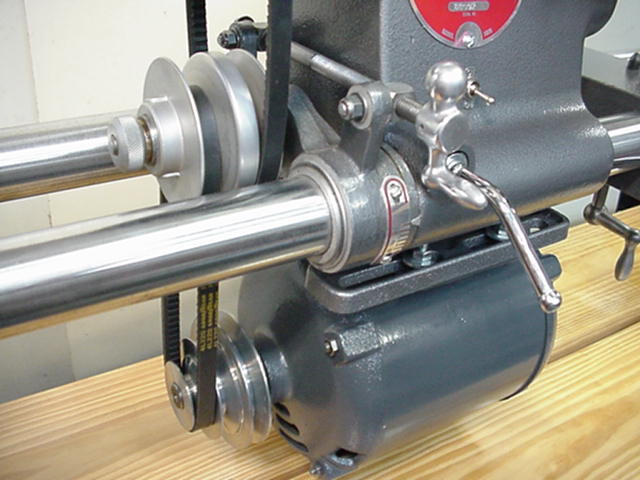

mrhart wrote:The speed changer is mentioned here several times. Anyone hace a pic or two they could post? Are they hard to come by?
Aren't parts for the 10ER hard to come by in general?
The speed changer was an 'extra cost option', so not all have them. Also they are easily 'broken' so that reduces the availability further. They go for in excess of $100 usually.
http://www.ebay.com/itm/Shopsmith-10E-10ER-Speed-Changer-/220963405803?pt=LH_DefaultDomain_0&hash=item337271ffeb
Notice this one is broke - caused by forcing the crank - notice the opposing springs - when fully compressed and further cranking takes place, that ear breaks off as shown.
I haven't seen one in person yet but here is a picturemrhart wrote:The speed changer is mentioned here several times. Anyone hace a pic or two they could post? Are they hard to come by?
[ATTACH]16470[/ATTACH]
from the MKCtools (Skip Campbell) web site. http://mkctools.com/index.html
Skip Campbell is also the moderator at the Shopsmith10ERusers group http://dir.groups.yahoo.com/group/Shopsmith10ERusers/
It is a great source of 10ER specific support and information, (check out the Files and Photos sections)

- mvc-615s2.jpg (48.17 KiB) Viewed 2618 times
Mine was broken just like that but was patched by the original owner. I just had my bro-in-law, who is a professional welder, weld that ear back on for me. I'm hoping it holds under pressure! But I kept the original owner's patch just in case...
