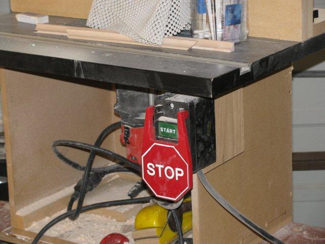

I picked up a couple of these from Rockler a couple of years ago when they were on sale. Mounted this one on my modified SS router table and absolutely love it
[ATTACH]16481[/ATTACH]
My intent was/is to use the second one to mount on the front rail of my 510. They say it is a 15 amp switch.
