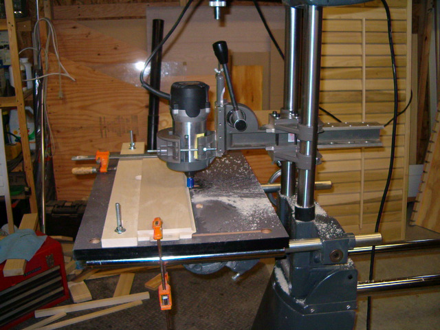

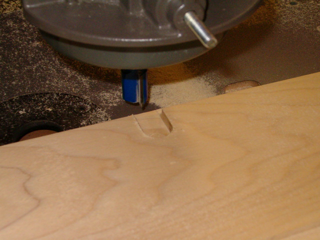

Just wanted to say - I used the OPR today to mill the control bar dadoes into the shutter rails. It took only 25 minutes to get the router arm out of storage, install the router, make the set up and mill two dadoes. I used the very bottom (far right) position of the main table and placed the arm where I had previously marked the way tubes with indelible marker. Took only an additional 10 minutes to disassemble the OPR stow it and lay the router on the bench.
Used the OPR table and the flat wooden fence (from sawdust session) layed on it's side. Result was good recesses for the control bar.

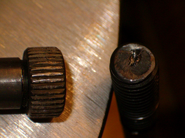

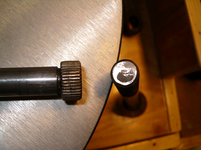

O.K. Ed - Tomorrow after I finish the shutter (I hope) I'll take the thing apart again and photo the results of my "fix". I have to use the OPR again tomorrow, anyway, because I forgot to mill the relief slots in the other two rails.
Here are photos showing the results of my "fix" for the ridges on the shaft and for the end of the handle bolt. Since the fix - the overhead router has been through two set-ups and removals. The last set up took only 12 minutes including installing the router. This is because I had marked the spot where the router arm attaches and the spot where the table goes. (The opr table was already on the main table.) I'm joing to post another thread telling my simple way to make set-up for verticle overhead routing.
I'm happy with the results of the fix and will keep all parts! No parts going back! I think the major single cause of my problem of handle movement although tight, was caused by the slanted end on the handle bolt. The handle when tightened, only touched the ridges at the highest point. This didn't give enough clamping pressure to hold the handle from moving. Yes, the bolt on the other end of the shaft was tight.

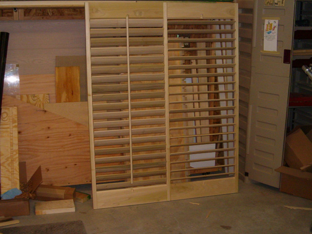

I'll even include a pix of what I was doing and the set-up. Finished the next shutter today. (except for painting) Painting will go fast with the HVLP equipment.
