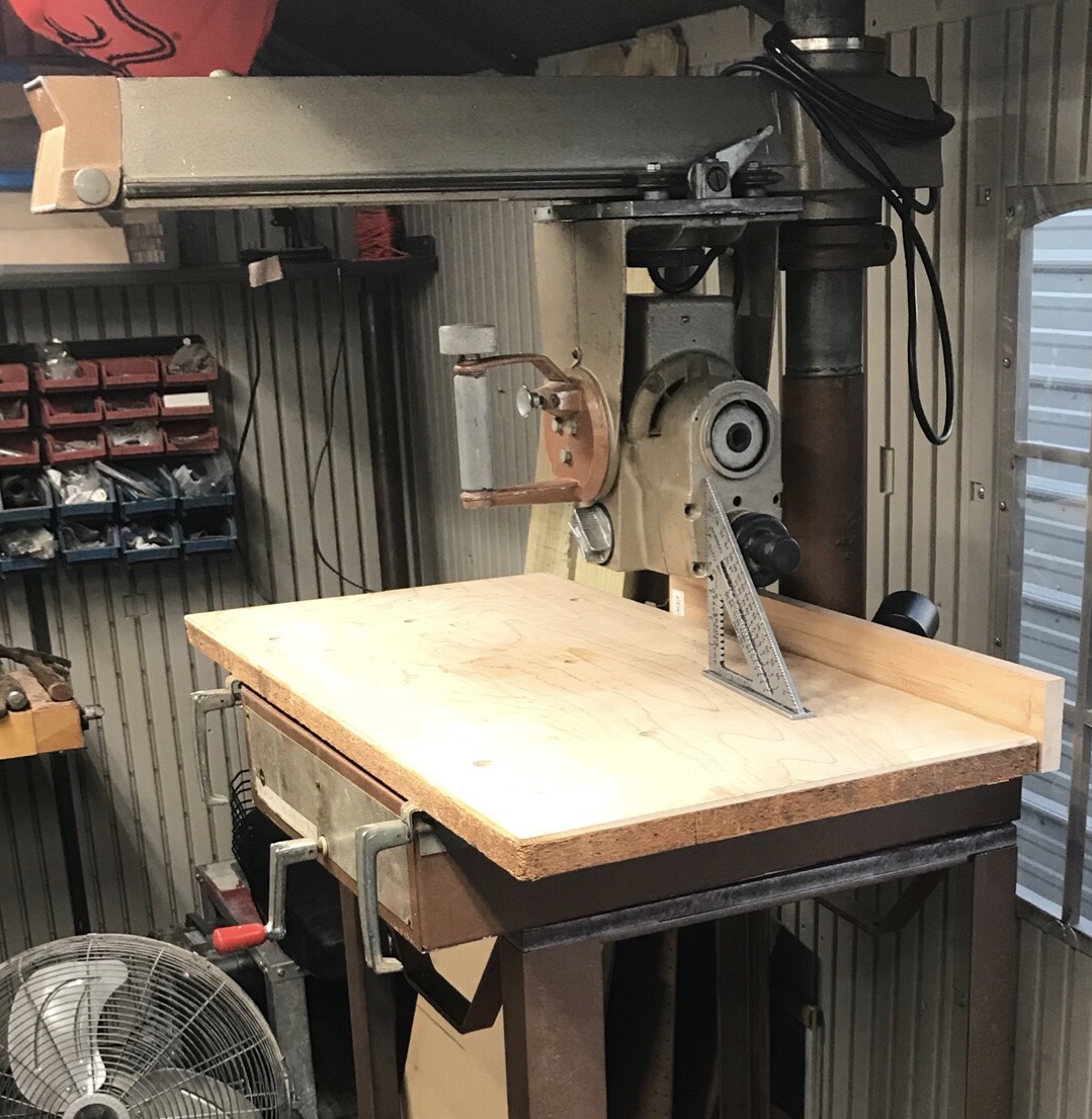

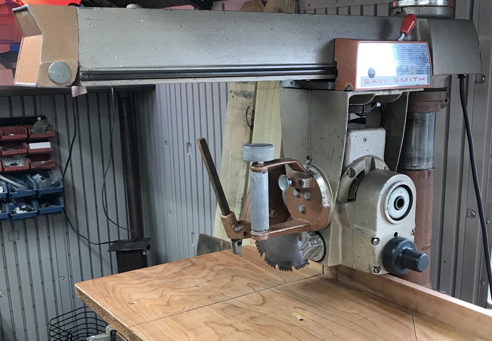

Restoring my Grandpas 1961 Yuba....so reviving this thread (hopefully)
The belt cover is missing the four screws that hold it on. Any chance someone knows the approximate size so I can get replacements? Any help will be greatly appreciated
Also the last outstanding question in this thread does the belt cover come off without removing the sheath with the hard to access setscrew?

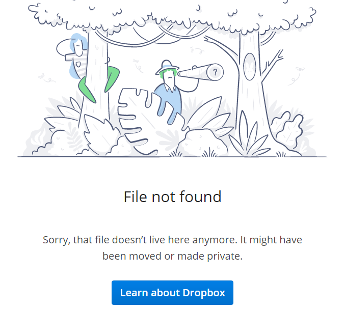

I could not get the PDF files I tried to download from the front page.
Could you check into that when you have a free moment?

Thanks for letting me know about that problem, Everett. The files were still there, but I guess the shortened DropBox links went away the last time DropBox made changes to their system. I updated the links with the full length link this time. Also added two new links - a Magna-Line Power Tools catalog from 1957 (even though this predates the Sawsmith RAS, I still thought it was interesting), and a zip file containing all of the documents in one download.

lioneldobie, the screws are 1/4-20 thread. Thread length is a little over 2-1/8" (2-3/16" maybe?). Overall length is 2-3/8" long. They also have a lock washer. The 4 screws are the only thing securing the cover, but it also holds the bearing on the end of the shaft. This may be gummed up and require a little persuasion to come off.

And complete!
Thanks to everyone who helped...and this thread in general
My Grandpa taught me on a radial so I dedicate this restore to him
