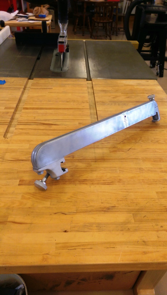

I got the rip fence done today. The only thing left is the main table top. I am still struggling with the best method to clean and polish the large aluminum parts. Does anyone have a suggestion?

You run out of beads?
Re: Restoring 10ER S/N 83974
JPG wrote:You run out of beads?
As we all know aluminum oxide is black. It is a PITA to clean the black off the large parts. I know there is no real solution so I just will have to deal with it as I have. Arrrgh!
Don't laugh! Try citrusstrip and a little elbow grease. It turns black(wonder where that comes from?)
Elbow grease is not the problem. I can do that. Everything turns black. It is aluminum oxide he said DUHH.JPG wrote:Don't laugh! Try citrusstrip and a little elbow grease. It turns black(wonder where that comes from?)
MickyD liked scotchbrite(I know not what color).
If one doesn't have large dip tanks and washers it is a problem with the larger parts.
No GI cans out thar?
I use Nyalox wheel brushes chucked up in my Shopsmith for most such chores. They come in three different "grits", from fine/gentle to moderately aggressive, and I have found each to be useful. Vastly superior to wire wheels, IMHO.
I used one a while back to test clean/polish a section of 10ER table, and that test section went just fine.
Yes, I have a few 20MM ammo cans that would work. I am just trying to eliminate the mess all together.JPG wrote:No GI cans out thar?
BuckeyeDennis wrote:I use Nyalox wheel brushes chucked up in my Shopsmith for most such chores. They come in three different "grits", from fine/gentle to moderately aggressive, and I have found each to be useful. Vastly superior to wire wheels, IMHO.
Yes, I want to try them also. I just need to get of dead center and get some of the alternatives in the shop to try.

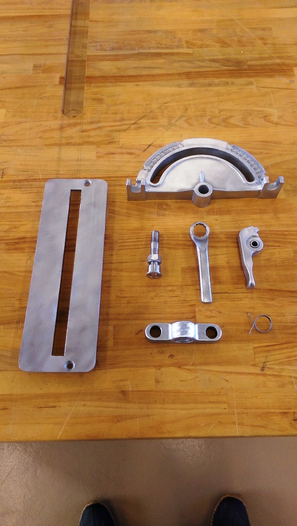

All of the table parts are cleaned except for the tops. This time I glass blasted them and then used a 2 1/2" cup fine "brass" (not) brush from Lowe's on the left end of the shorty. Worked like a charm, fast and no cleanup on both steel and aluminum.
I still want to try the product Dennis mentioned. I can't find it locally so I will have to order it.
Anyhow,table tops left to do and the restore will be complete.
