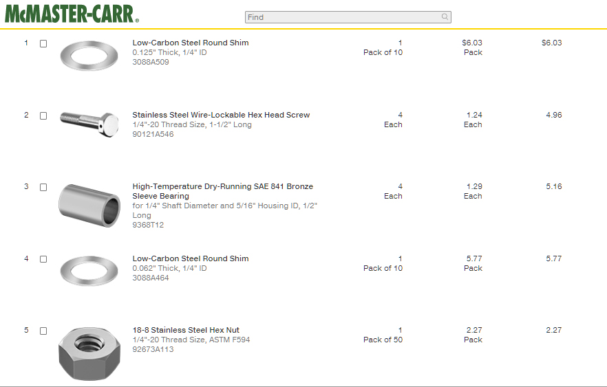

Well, decided to buy all the parts to make the double-bearing assembly, seemed easy enough - bearings from amazon all other parts in 18-8 stainless from mcmaster.

I replaced the guides in mine with the Carter guides recently, but I didn't replace the back bearing behind the blade. I would be curious to know which parts numbers you went with and how your installation goes. Were you able to get the quantity that you needed, or did you have to buy extras?r33tc0w wrote:Well, decided to buy all the parts to make the double-bearing assembly, seemed easy enough - bearings from amazon all other parts in 18-8 stainless from mcmaster.

Bearings: Pack of 10 for $8
https://www.amazon.com/gp/product/B07H8 ... UTF8&psc=1
Got one extra of the items that didn't come in a pack. I think I got the right stuff, the nuts shown in that .pdf posted somewhere in this thread show only 1/8" - 3/16" thick and i believe the ones i got are 7/32" thick so hopefully this isn't a hindrance.
The cost was about the same as buying shopsmiths version and but piecing it together gives me backups. I'll give an update when i get all the pieces in and installed

Sounds like you might have extra on most of the pieces then. If so and you won't to defray some costs, let me know if you want to send me a set and I can pay you. Just send me a private message and we can coordinate. Thanks.r33tc0w wrote:Bearings: Pack of 10 for $8
