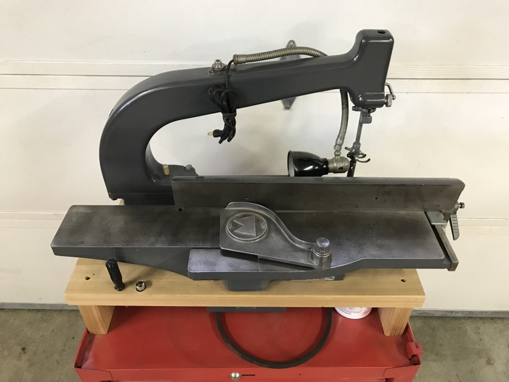

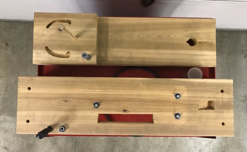

I have shown pictures of the Model 4E Jointer and Model A-34 Jig Saws in this thread but have recently been asked about the storage platforms I made for them. Below is a picture of the Model 4E Jointer (foreground) and the later Model A-34 Jig Saw (background) which sit on top of a rolling tool cabinet base.
_
Jointer and Jig Saw stands 1.jpg (96.07 KiB) Viewed 60634 times
These are two separate stands made to fit on top of the cabinet. Both are made from 2 X 8's leftover from making Model 10 benches. Both are able to support the tools even though the cabinet gets moved around often. The Jig Saw does not wobble on the stand at all. Both have a standard (for each tool) Shopsmith SPT cover for storage.
The Jointer has the bracket attached to it during storage so only the bolt has to be tightened connecting it to the special headrest on the Model 10. The bracket sits down in a slot cut into the storage platform as shown below. The Jointer sits on the platform flat against the bottom of the base. There are three bolt thread ends that come up through the board that match the three mounting holes for use when on a homemade bench. The table height handle has a angled down cutout for it to go into. Keep in mind the Model 4E Jointer like the early Model 620 have a smaller table height adjustment handle so not very much of it protrudes below the base. The two holes near each end are for recessed screws that attach the legs which raise the board up enough for the bracket.
The board for the Jig Saw has a routed out space for the belt cover area of the later A-34 Jig Saw. It is on a double thick end and includes a dowel to go up through the mounting bolt hole. The other end has a hole for the lower end of the gear housing.
_
Jointer and Jig Saw stands 2.jpg (97.29 KiB) Viewed 60634 times
I still need to redesign a similar Jig Saw stand for the early A-34 Jig Saw I have restored and am keeping but without the partial belt cover of the later Jig Saw I need to come up with a support for that end. Probably a rounded piece to match the contour of the Headstock with a dowel to go up through the mounting bolt hole.

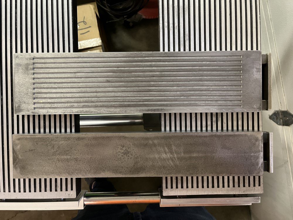

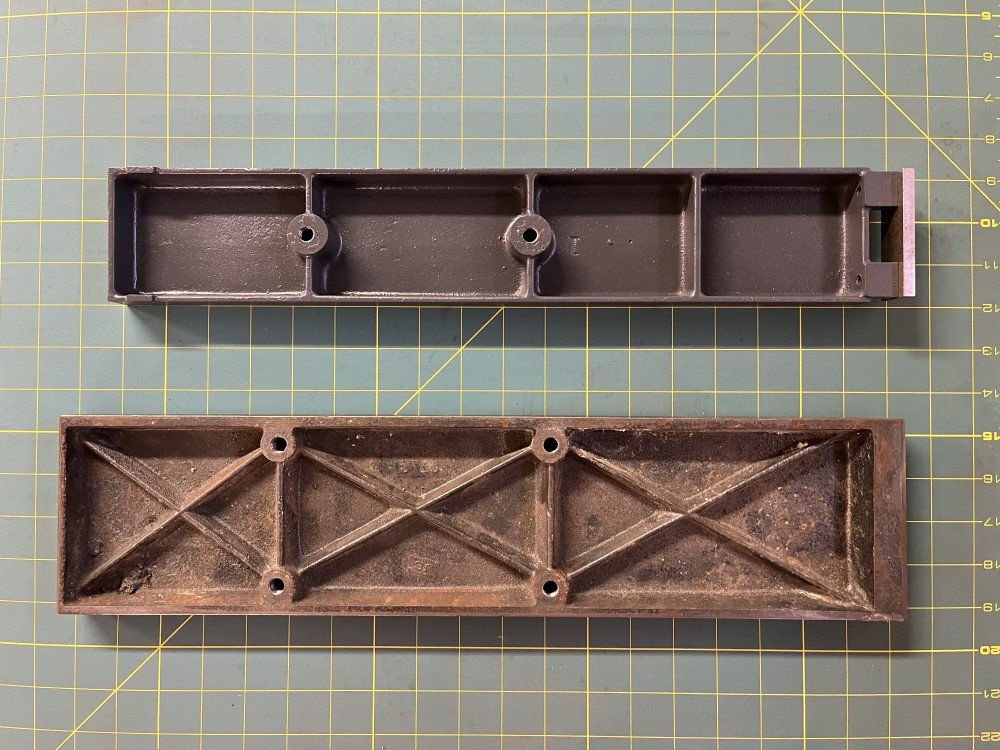

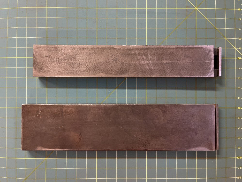

In previous posts we had talked about the rare Cast Iron Extension Table. Part of that discussion tried to determine when the Cast Iron Extension Tables were made. So, a little history at this point may help. The Mark 5 was in design, engineering and testing for some time while the Model 10ER was still being made and sold. Very recently I found and purchased a Mark 5 Cast Iron Extension Table. It is the only one I have seen although there are around 4 of the Model 10 Cast Iron Extension Tables we know of. I now believe that during the testing of the Mark 5 some Cast Iron Extension Tables were made and the ones for the Model 10ER were also made as a test in the table design around that time. Most of the Cast Iron Extension Tables for the Model 10ER came with the longer bracket which was a later change for the Model 10ER. The bracket and the existence of a rare Cast Iron Extension Table for the Mark 5 lead me to believe they were both made at that time. This is only speculation and I could be totally wrong but based on what I know it is my best explanation.
As to how these Cast Iron Extension Tables got out into circulation is anybody’s guess too but here are a couple possibilities, over the years the Shopsmith line has changed ownership and they may have come from clearing out extra stock. Another is they may have been on demo units that were later sold. Of course, these are only guesses and we may never know the real way they became available.
The pictures below are the Model 10 Cast Iron Extension Table on top and the Mark 5 Cast Iron Extension Table on the bottom.
_
M5 - 10 CI Extension Tables top.jpg (146.53 KiB) Viewed 59810 times
M5 - 10 CI Extension Tables bottom.jpg (173.97 KiB) Viewed 59810 times

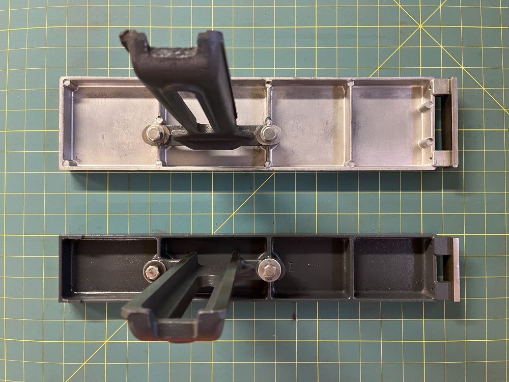

The pictures below show the Model 10 Extension Tables with the Aluminum on top and the Cast Iron on the bottom.
_
CI and AL Extension Tables top.jpg (199.02 KiB) Viewed 59810 times
CI and AL Extension Tables bottom.jpg (141.81 KiB) Viewed 59810 times

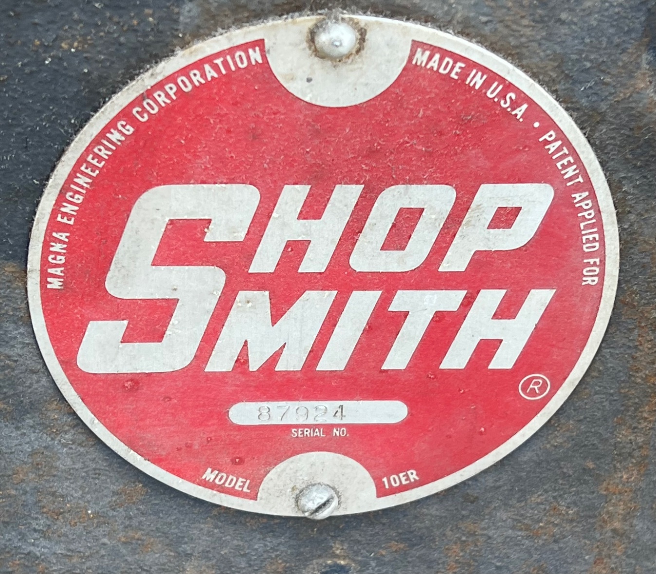

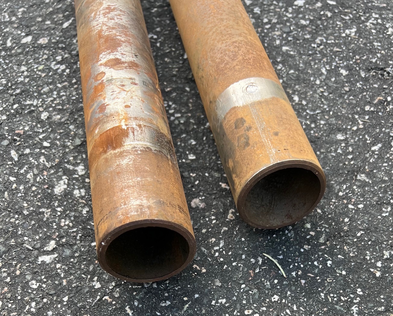

chapmanruss wrote: Sun Jun 07, 2020 1:16 pm If any of you have those higher (around 80,000 and above) serial numbered Model 10ER’s let us know if they have the thin walled Way Tubes.
I picked up serial number 87924 a few weeks ago, and it has thin walled way tubes and hollow table posts.

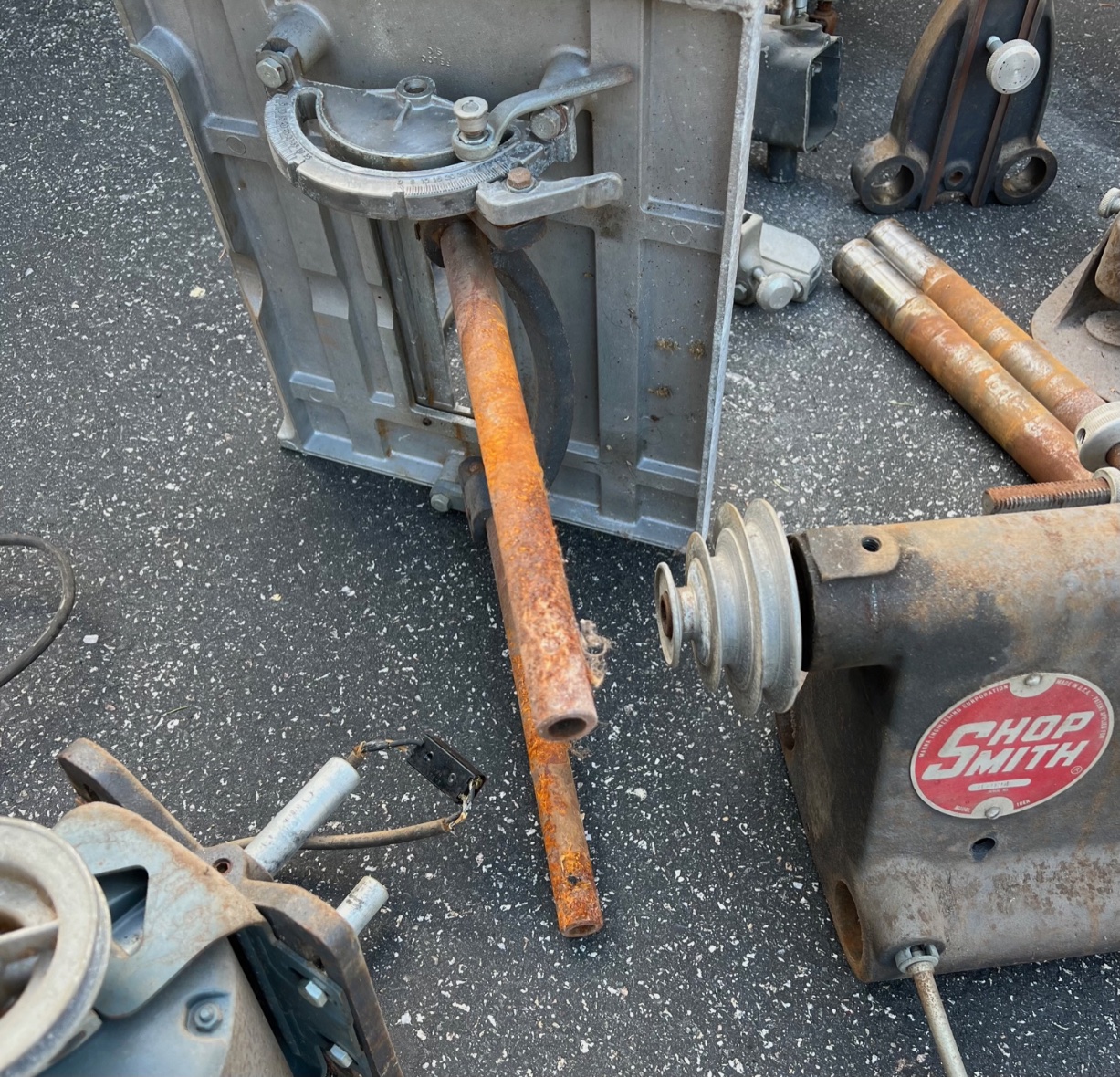

Hoping you guys can help a fella out. I just got this Shopsmith and it was given to me so the price was right (I hope). Now I need info on it. I've never had one and never really been around one. Have been searching the internet but there is a lot to go through. I'm guessing this is a 10ER, with serial #R47353? I want to fix it up to use, not going to be a show piece. Can you all tell me what I have for sure and if I need to know anything in particular about it.
Re: Shopsmith Model 10's What When and Where
Posted: Sun Mar 06, 2022 1:11 pm
by DLB
I'm not a Model 10 guy, but one thing I can tell you is you got a great "buy." You have the speed changer which, if intact, is what generally separates used Model 10's from one another. That alone is probably worth more than a complete Model 10 without one in my area.
- David
Posted: Sun Mar 06, 2022 2:48 pm
by chapmanruss
whiteb01,
First welcome to the Shopsmith Forum. Your Shopsmith Model 10ER (even though it says ER) was made in later 1950 in the Western Plant as indicated by the R of the serial number prefix.
Something I noticed in the picture of the entire unit is the Headstock's Way Tube Lock is missing. That may explain why there are hose clamps on the Way Tubes between the Headstock and the Carriage. Since I cannot see all of the Quill Return Spring Housing I cannot tell if you have Headstock version 4 or 5. It changed around the time your Model 10ER was made. Either way the missing lock for the Headstock would be the double wedge type. The picture below shows the three locks used on an early Model 10E and are similar to the ones used on the early 10ER. The top one is the Quill Lock and the middle and bottom locks are for the Headstock Way Tube Lock and the Carriage Way Tube Lock which are the same. The ones shown in the picture below are the very early brass wedges which was soon changed to wedges made out of an alloy. The later single wedge locks will not work in your Model 10ER.
_
Lever Assemblies 1077.jpg (280.47 KiB) Viewed 59497 times
Note in the picture above the lever of the Quill Lock is different than the ones for the Headstock and Carriage. The Quill Lock in your Headstock is keyed which was used only in the version 4 and 5 Headstocks. As with the locks being double vs single wedges some parts are not interchangeable on their own. Some things would have to be changed as an assembly. Since your Shopsmith is over 70 years old replacement parts have to be found on the used market. Generally used replacement parts are not hard to find.
As David noted you have the Speed Changer with it that looks to be complete. They are a nice addition to the Model 10's but do be careful as they can be easily broken with incorrect use. Never try to adjust the speed past the point the springs on the rear of the screw assembly begin to compress. The speed will not go any higher or lower but you can brake the unit.
Some rust removal, cleaning up and paint if desired and you will have a great woodworking machine. One of the things I like about these Shopsmiths is with a little care they can seemingly run forever. I encourage you to start your own thread to ask questions and share information about your Shopsmith Model 10ER as you get it up and running. That will keep your information specific to your Shopsmith in one place.
