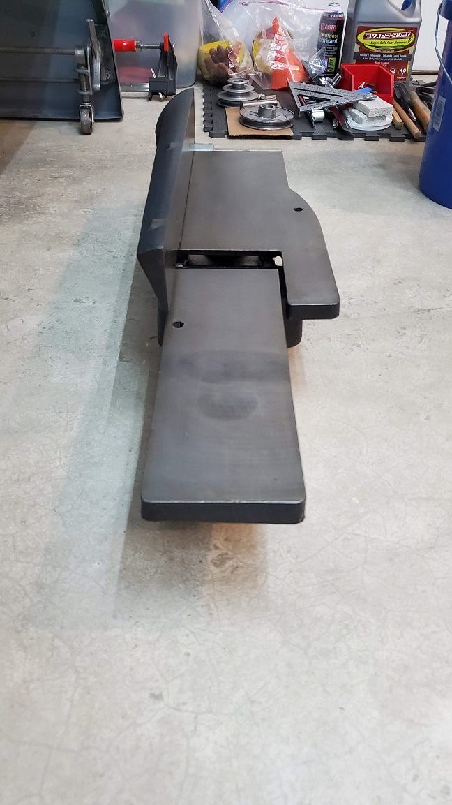

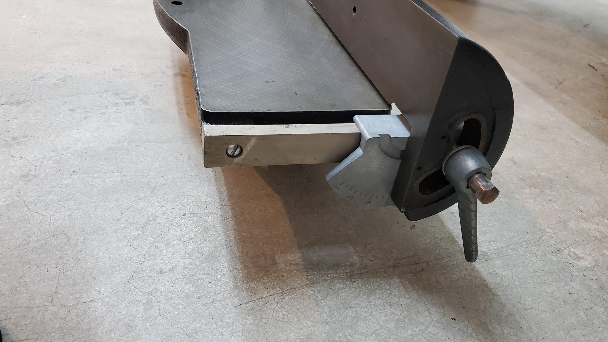

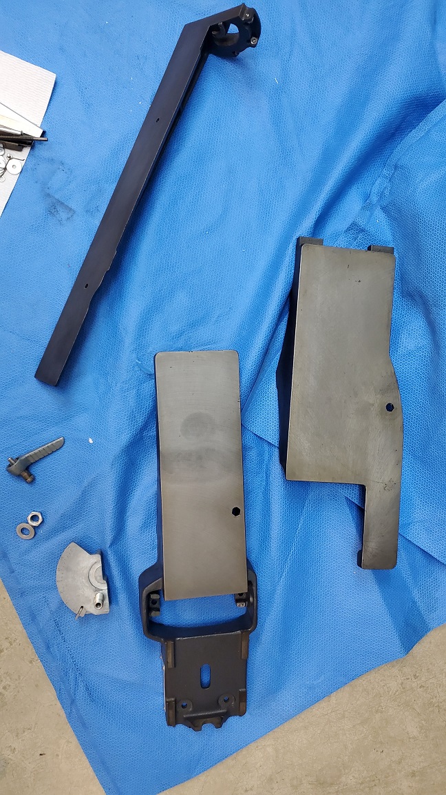

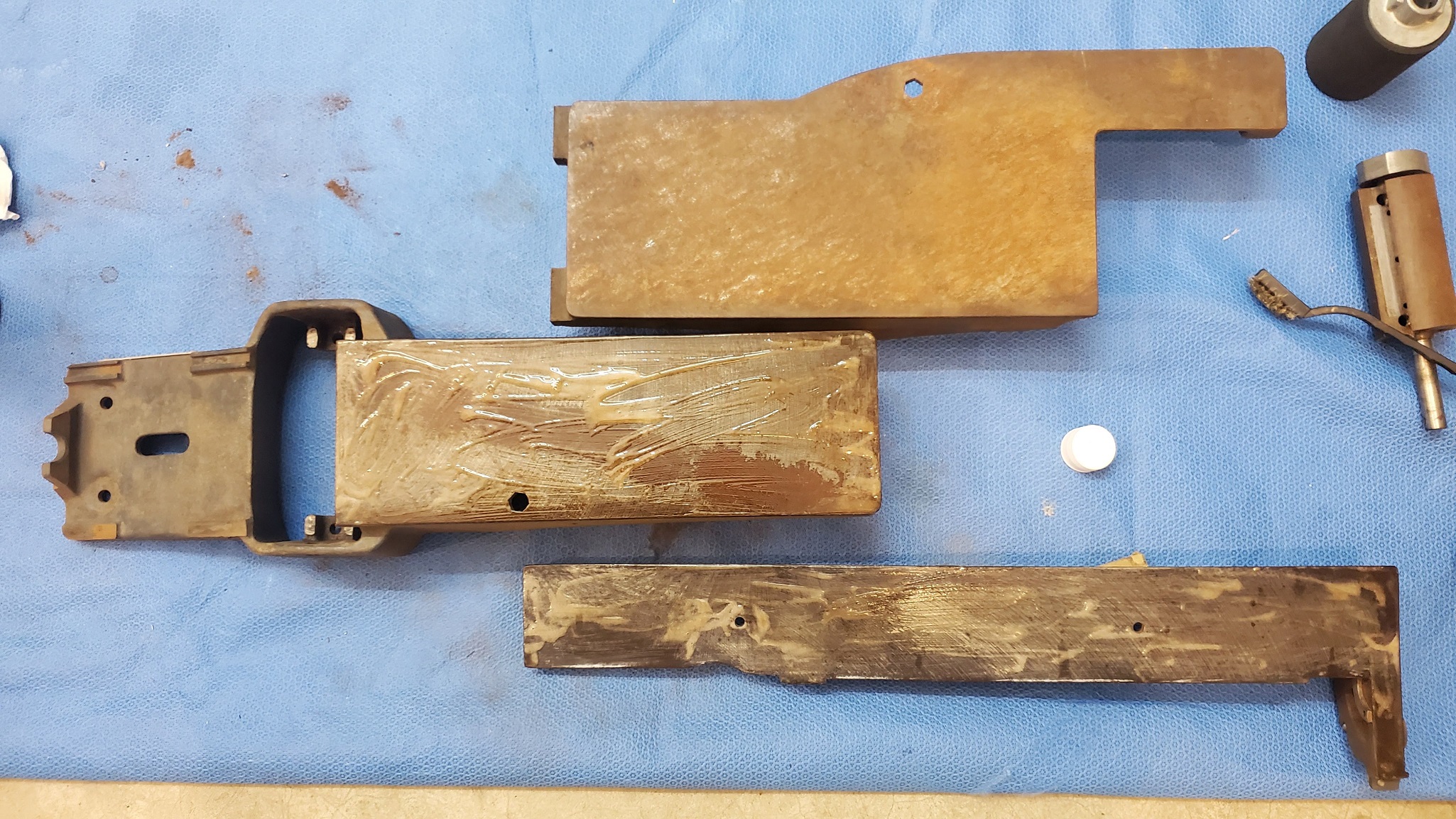

Here is the cleaned jointer. Still working on the cutting assembly.
- During the first rust removal
- 20200709_103208.jpg (940.24 KiB) Viewed 8929 times
- 20200710_213821.jpg (347.43 KiB) Viewed 8929 times
- 20200710_235628.jpg (592.75 KiB) Viewed 8929 times
- 20200710_235617.jpg (200.02 KiB) Viewed 8929 times
- 20200710_235602.jpg (662.7 KiB) Viewed 8929 times

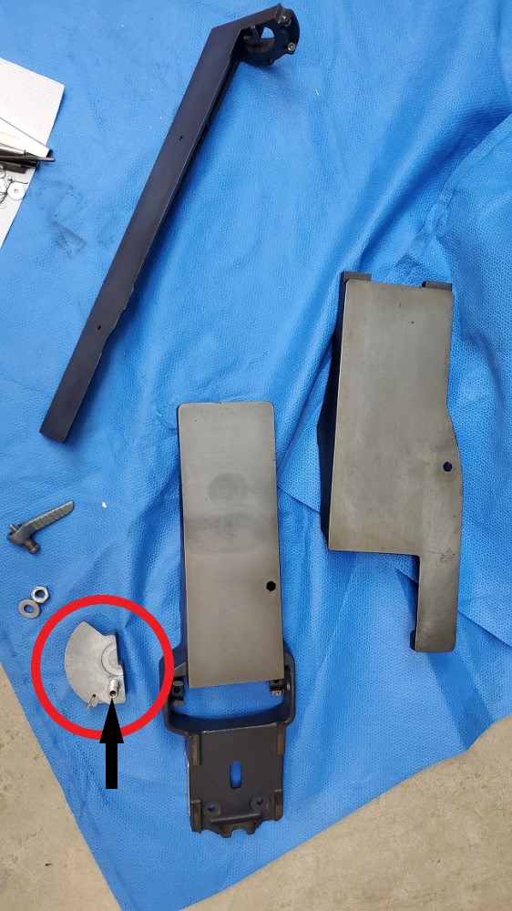

The Jointer is coming along beautifully. I will add a word of caution here. This is actually true for all of the Jointers models made through the years. Be careful not to over tighten the fence locks. The threaded sleeve can strip out the threads in the Quadrant there by needing replacement. See the circled item and the arrow in your picture below. My 4E Jointer had this problem when I purchased it. Now the good news the Jointer Quadrant is the same now as back in 1953 when the Model 4E jointer came out. It is also one of the 17 most common ordered replacements parts. It is the weak link for the Jointer.

The open joint that slides on the front rail can become splayed due to over tightening as well.

I did use jelly on the metal bench ends.JPG wrote:Looking GOOD!!!!!!
Also glad to see a gallon container of evaporust rather than navel(sp?) jelly!!
