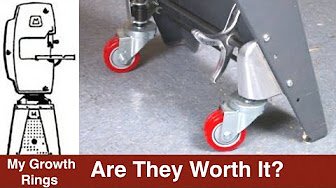

Econo and Premium Wheel Upgrades for your Shopsmith Casters: Are They Worth It?
Post by Chad »
Watch it here: https://www.youtube.com/watch?v=4rD7MPk ... B&index=47
If you move your Shopsmith tools on Shopsmith casters eventually you will need to replace the wheels, and if you own the Mark 7 and/or the heavy PowerPro headstock, IMO, polyurethane wheels are a mandatory upgrade.
The great news is we now have a couple choices:
1.) We can replace them with the same hard-plastic OEM wheels that have served us just fine all these years, or
2.) We can upgrade them with softer, smooth-running polyurethane wheels, or
3.) We can upgrade them even further with Shopsmith's official Premium 3" polyurethane wheel upgrade. But which one is most worth it?
0:00 - Intro
0:16 - A bit of history and how they work
0:56 - The problem with Shopsmith casters
1:29 - 3 replacement wheel options
2:11 - Installing the Econo version
2:24 - Flipping the Mark V with the Headstock OFF
2:39 - Installing the Premium Shopsmith 3" polyurethane wheels
3:15 - Flipping the Mark V with the Headstock ON
3:20 - Removing caster assembly
3:46 - How the Shopsmith 3-position caster assembly works
6:41 - Drilling the legs for the Shopsmith Premium 3" polyurethane wheel upgrade
8:15 - Mounting the caster assembly higher on the legs
8:58 - Pressing in the new wheels
9:24 - Lifting the Mark V back onto it's feet.
9:39 - Taking the new casters for a test drive
9:50 - Final thoughts and my recommendation
Products used in this video (in no particular order):
- Here's the oil I use to lubricate the wheel stems (Yes, this is the same oil I used on the sheaves): https://amzn.to/32IkpAQ
- Econo wheels for the Shopsmith caster assembly: https://amzn.to/3nQVCTt
- Shopsmith Premium 3" Caster Upgrade: https://amzn.to/396fsWp

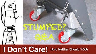

STUMPED? Q&A's from Two Easy Upgrades for your Shopsmith Casters: I Don't Care & Neither Should You!
Post by Chad »
Watch it here: https://www.youtube.com/watch?v=FtvP2Qt ... B&index=48
In our previous video, we installed and discussed upgrading the hard-plastic OEM wheels with softer, smooth-running polyurethane wheels, and upgrading with Shopsmith's official Premium 3" polyurethane wheel upgrade. Watch that video here: https://youtu.be/4rD7MPkEJOc
0:00 - Intro
0:44 - No, the 3" wheels don't give you more clearance
1:05 - Rolling smooth
1:35 - I Don't Care and Neither Should You!
3:55 - An alternative to flipping the Mark V upside-down
4:33 - Use a straightedge to adjust with the spacer washers
5:31 - Can you use the 3" casters on a SPT Stand?
6:40 - THANKS!

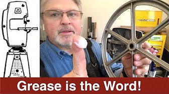

Shopsmith Bandsaw Maintenance: Greasing the Upper Wheel (How I Fold a Bandsaw Blade & Why I Don't!)
Post by Chad »
Watch it here: https://www.youtube.com/watch?v=H1YPHGe ... B&index=49
In this video, we'll cover the greasing of the upper wheel of the Shopsmith bandsaw, which in my experience is among the most easily forgotten maintenance of the bandsaw. It's so easy to do that there's no excuse for letting it go another week.
Don't forget to leave your questions, comments, and Cheapshots below and we'll address them during our mid-week video.
0:00 - Intro
0:27 - Needle bearings
1:20 - How is the upper wheel retained?
2:20 - Removing the blade
3:19 - BONUS! How I fold a bandsaw blade and why I don't!
5:15 - Removing the upper wheel
6:36 - Removing the old grease
11:22 - What you don't want your wheel to do
11:59 - How do we add grease and what grease should we use?
14:11 - Can you use White Lithium Grease?
15:39 - How to add the grease to the bearings
18:15 - Can you replace the bearings?
LINKS to products that were used and discussed in this video (in no particular order):
- Super Lube 41150 Synthetic Grease: https://amzn.to/2JbG5Pv
- Super Lube 31110 Aerosols, Multi-Purpose Spray Grease: https://amzn.to/3mk3yME
- Super Lube 11016 Aerosols Dri-Film (I use this on the Quadrant): https://amzn.to/33si0L0
- Permatex 80345 White Lithium Grease: https://amzn.to/2Vg001V
- WD-40 Degreaser: https://amzn.to/3fMWrK5
- The hose rack I use in my shop: https://amzn.to/2HQnRCn
