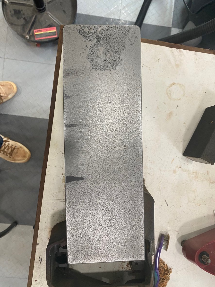

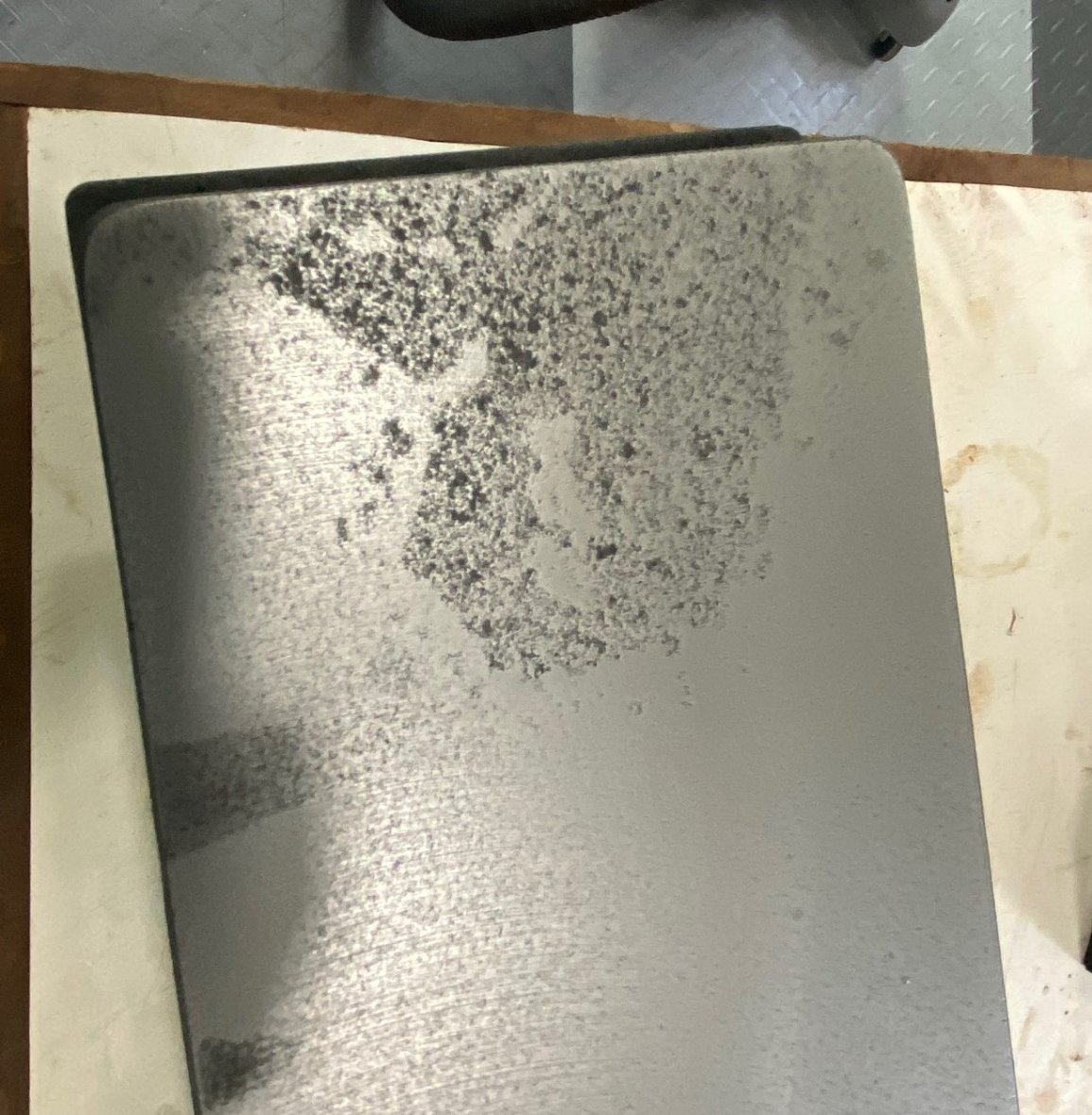

Here's the outfeed table after the Evaporust bath and some metal polish. There is some minor pitting at the end, I don't think it will be an issue.
jointer 92.jpg (241.37 KiB) Viewed 1886 times
jointer 93.jpg (219.27 KiB) Viewed 1886 times

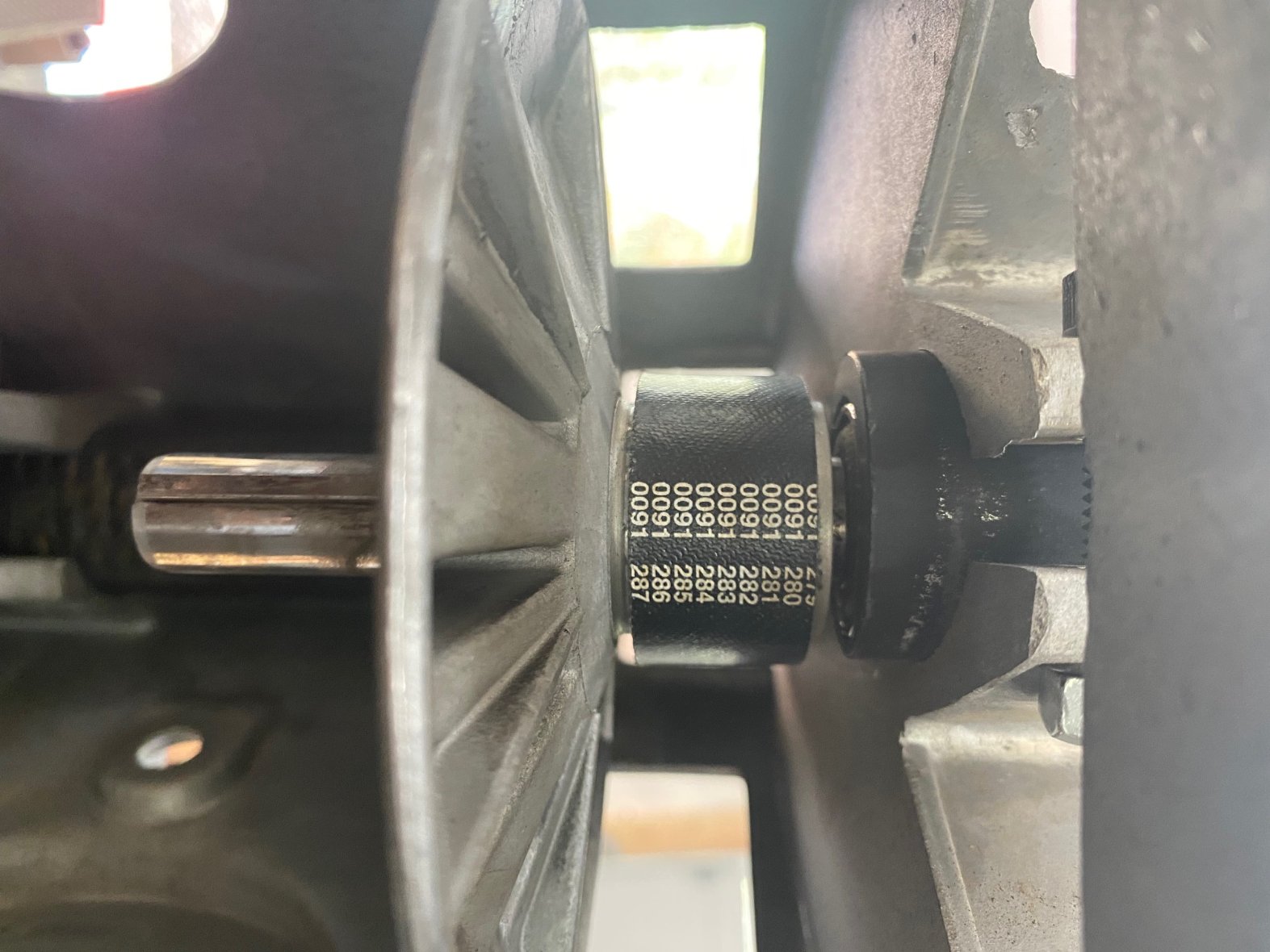

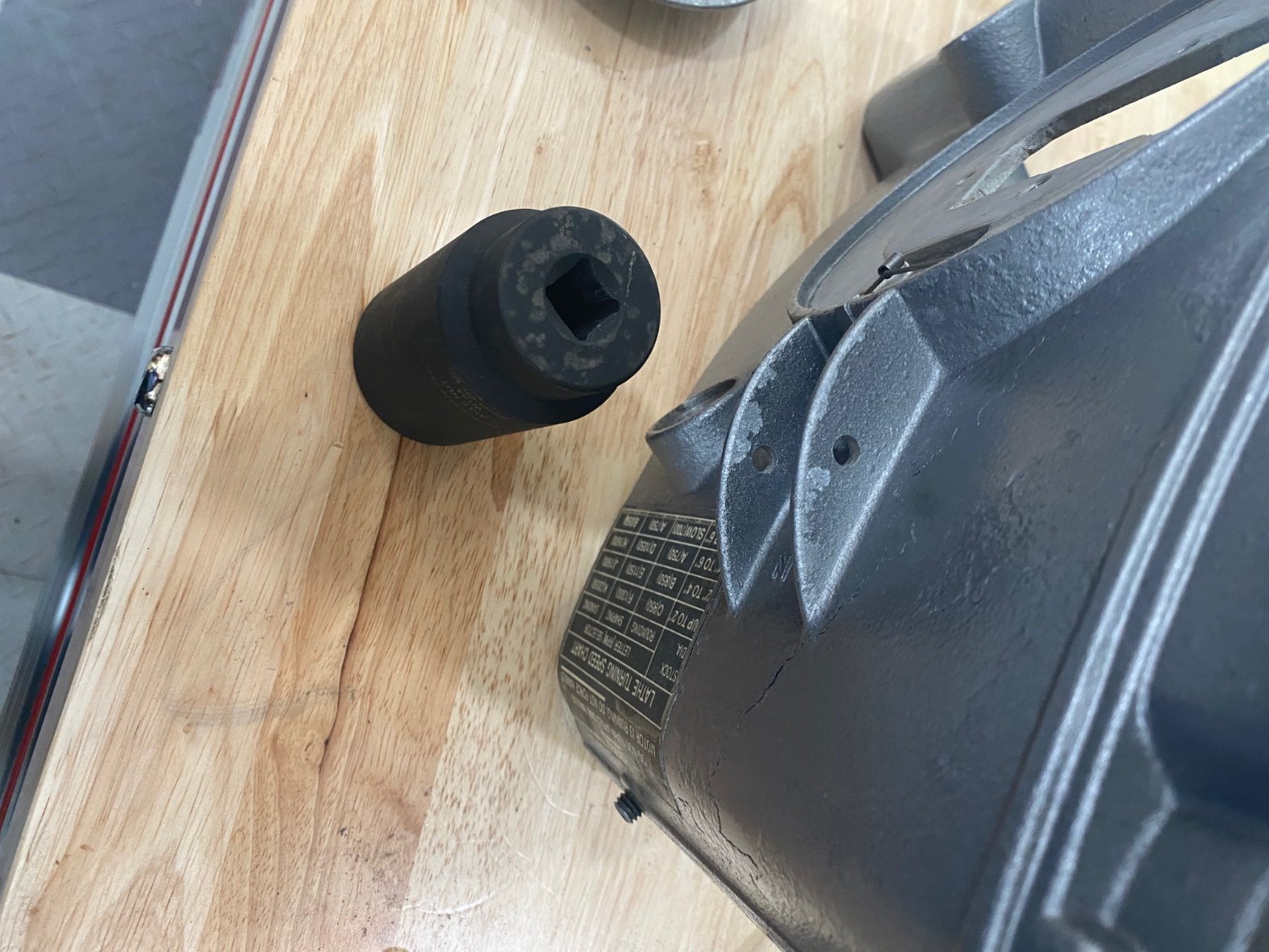

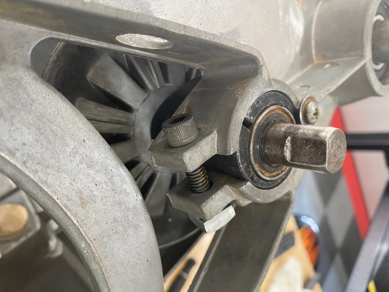

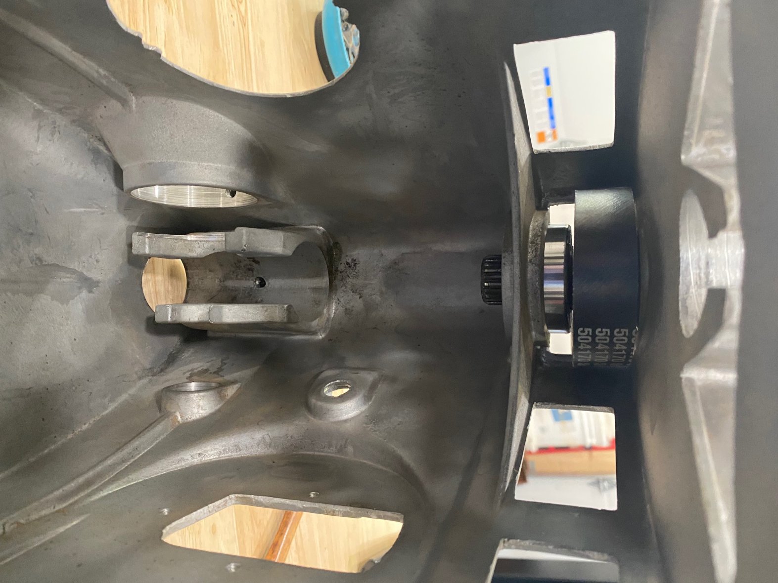

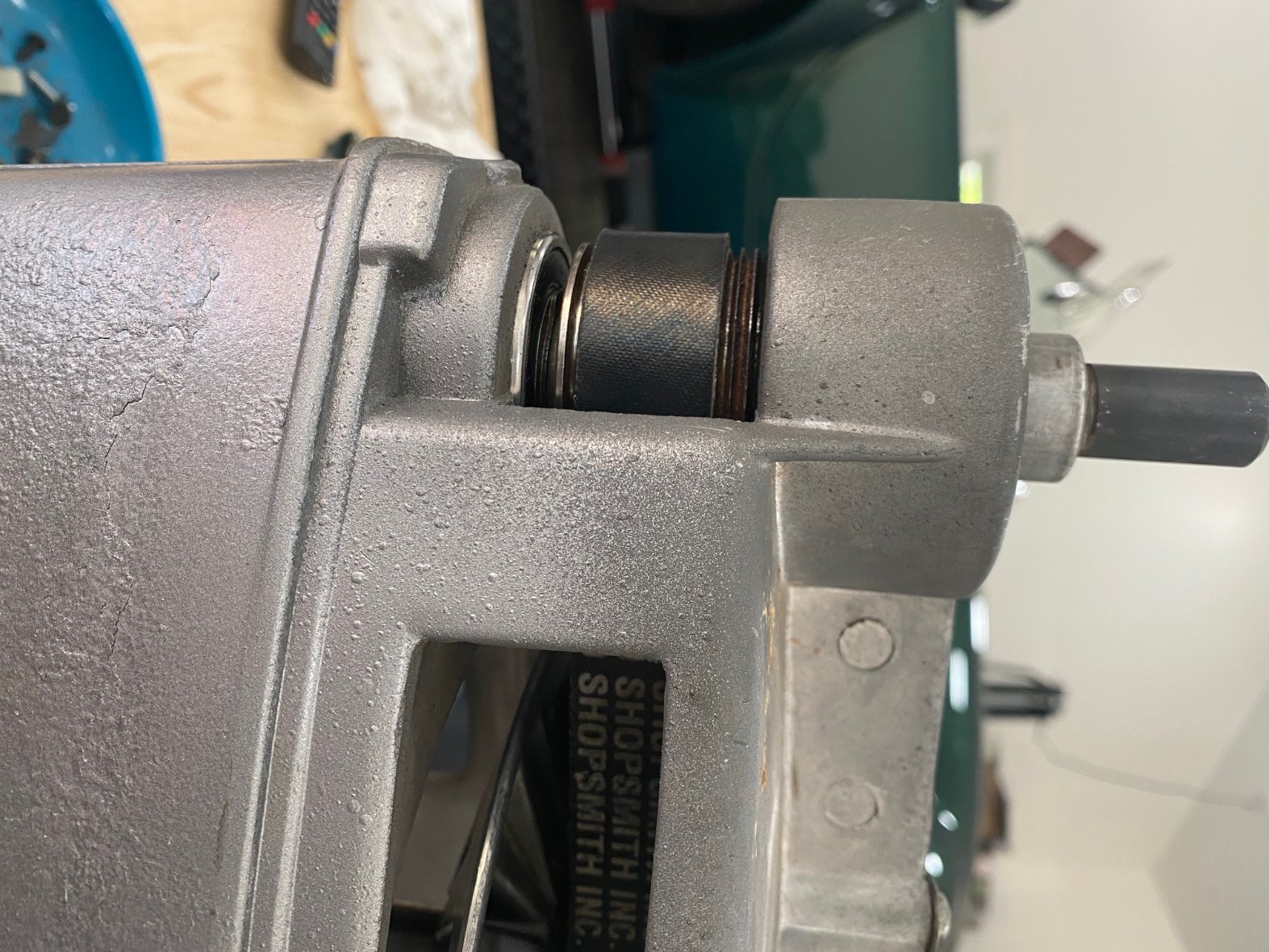

Finally all the parts arrived and I can start putting it back together.
Upper shaft reinstallation
Upper 1.jpg (240.23 KiB) Viewed 1827 times
Upper 2.jpg (278.34 KiB) Viewed 1827 times
Upper 3.jpg (213.04 KiB) Viewed 1827 times
Found a 36mm Ford axle nut socket works great to seat the spring clip
Upper 4.jpg (303.32 KiB) Viewed 1827 times

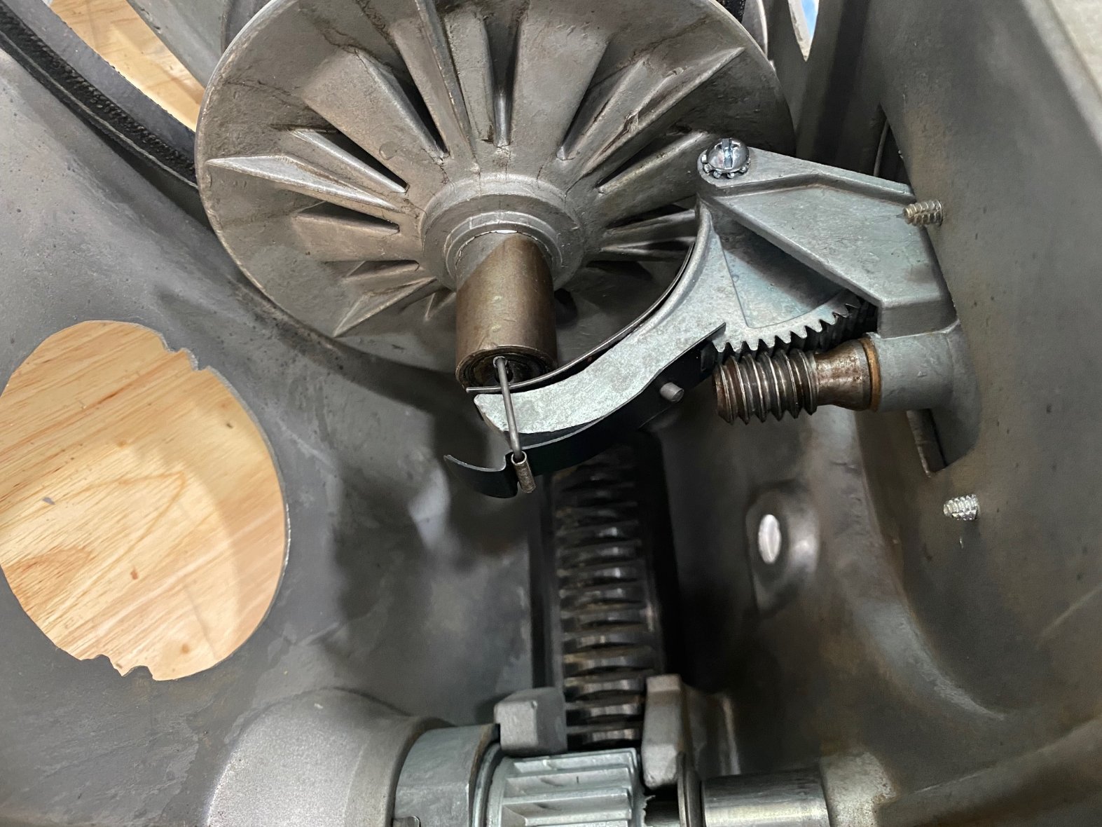

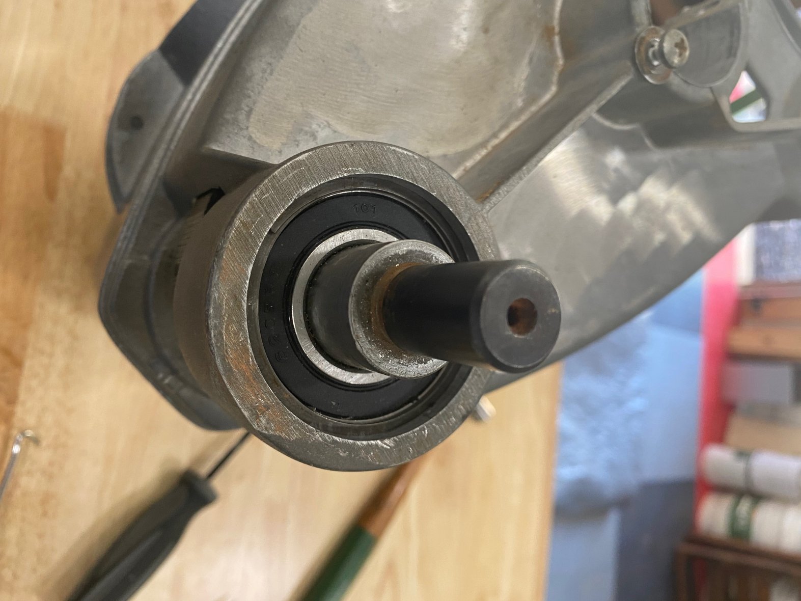

Idler is in, how's it look
idler 1.jpg (278.73 KiB) Viewed 1810 times
idler 2.jpg (210.95 KiB) Viewed 1810 times
idler 3.jpg (378.88 KiB) Viewed 1810 times

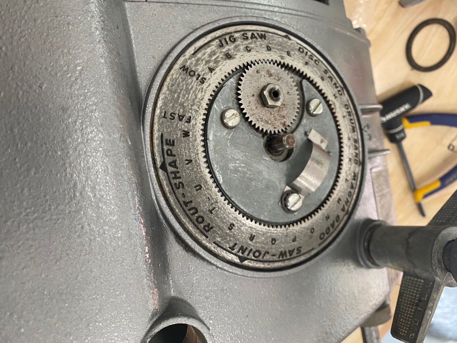

Speed control in. Here's s quick video. Not sure about the noise, did I forget to lubricate something?
https://youtu.be/nP83ajA5cJA
speed control 92.jpg (301.51 KiB) Viewed 1798 times
speed control 93.jpg (373.71 KiB) Viewed 1798 times

John4337 wrote: Fri Oct 22, 2021 3:27 pm Speed control in. Here's s quick video. Not sure about the noise, did I forget to lubricate something?
Guessing here - Maybe that's the button sliding along the face piece on the new pork chop (aka speed control quadrant.(?) Is it quieter going the other direction? I don't lubricate that face but JPW would not hurt it and might confirm the source of the sound. That face usually has a shiny wear line on it after some use, and I know it starts out a little rough. The most important thing is that the control sheave slides smoothly and easily on the shaft. I see you did the Bill Mayo improvement, good one. ;)
I noticed that you put the upper drive in before putting the Drive and Ring on it. Did you have any trouble doing it in that order? I'm wondering about leverage to seat the Ring.
- David

Thanks all, traced it to the flat spring under the speed handle, guess it was rubbing on the back of the handle. I put some wax on it and it got better. Probably couldn't hear it with the motor running anyway

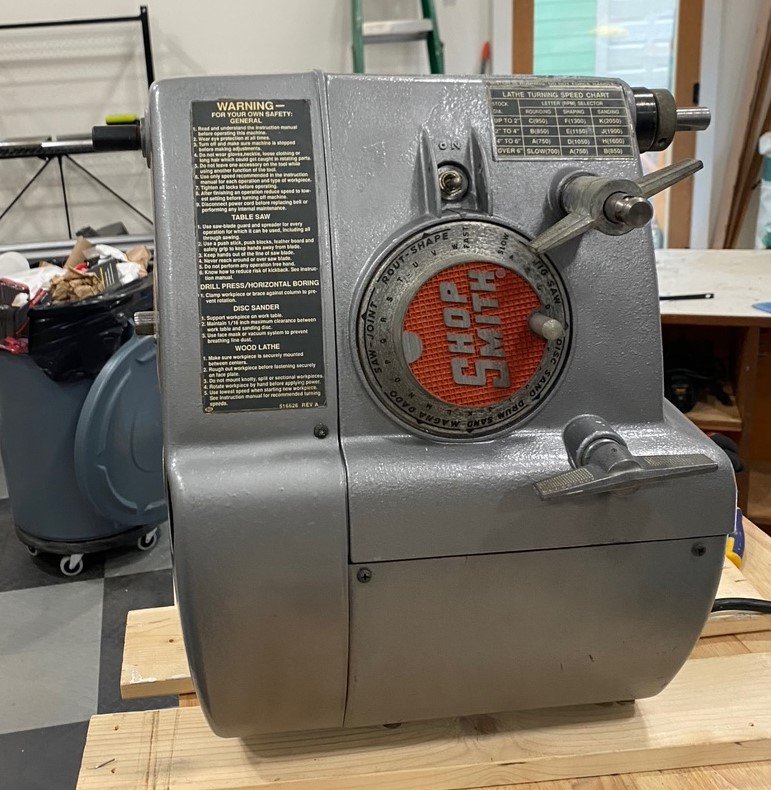

Well, done, and surprisingly, no leftover parts.
Done 2.jpg (136.92 KiB) Viewed 1775 times
